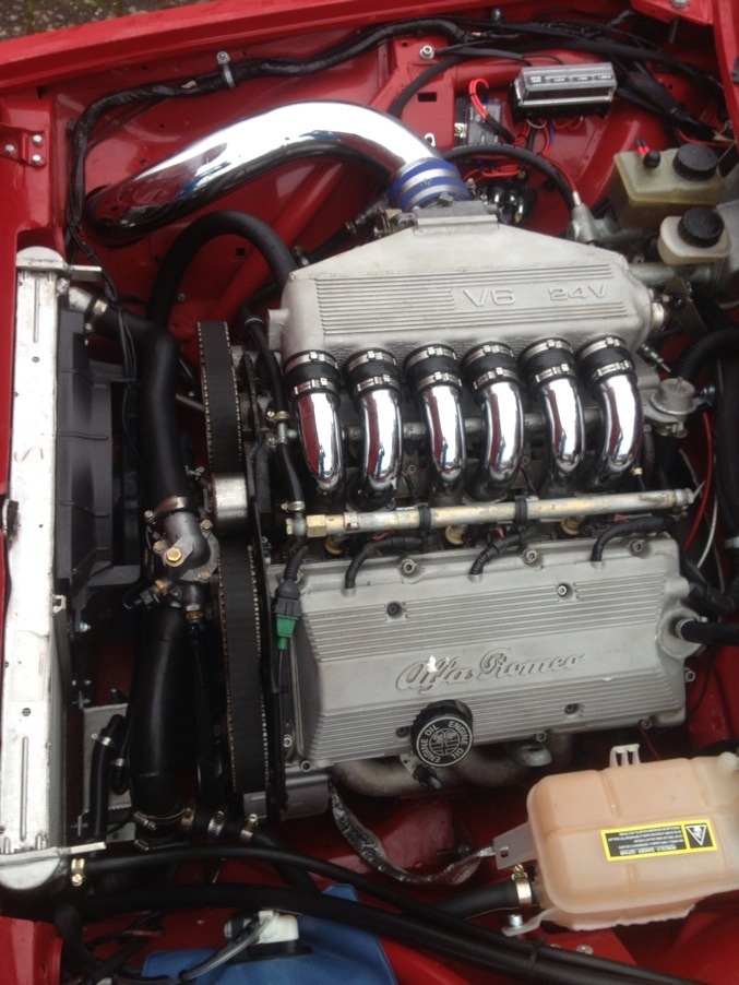

Looking good Jim , from my side on subject of plennum and from my mates in SA the bigger throttle body made no difference apart being difficult to map at low rpm even on the 3.7 motors so I doubt it will be any better on the 3.2 .
The tapered plennum on side delivered really good power on number of 24v motors we raced and was the easiest to build . It might not look the prettiest but we sure hit our hp figures we were looking for even with our short exhaust headers which are no where near as efficient as your stuff . I also cut the metal part of the side plennum that goes over the coils on the race motors to eliminate heat soak but not ideal on every day road car with a vented bonnet as moisture crept in .
At least if you go side plennum your hp figures can be more identifiable with the guys having 24v motors in the FWD Alfas .
Side plenum with taper in referring to is in below pic .
Re: Jim K. 3.2 engine
Thanks Kevin, that's what I had in mind to build after seeing so many similar jobs, except the hole in the body work which is not necessary in my case. I am also contemplating making a single 6xthrottle body, thin ~20-25mm to superimpose between plenum exit and rubber pipe connectors. It will actually bolt flat on plenum exit and the 6 plenum exit throats will be attached to TB backside. I have to think it some more though... 8)
