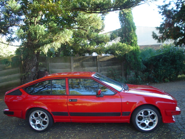

Anyways ,I may be VERY optamistic,but I would love to build the alfetta to have the spats and wide wheels on like that Chats car,will I be able to get repro spats,and how rare are the wheels?
The chap you bought the car from has the fibre glass spats ex stock.Chat to him..Then bring your bank account with and come get the wheels ,hubs and brakes that go with all that.. 8) 8)
IMG_3808 (2).JPG (126.36 KiB) Viewed 11100 times

Barry what are the spec's for the wheels (width and offset) and tyres (width and profile) on your GTV6 as they fill the guards beautifully. Any rubbing issues or mods needed to avoid?
Jason
1983 GTV6 2.8 litre
Ah,ok..I turn up my own wheel spacers an stuff as I deem necessary..
The rears are 17x7 et 34 with additional 30mm spacers..hehe.. 8)
The fronts are the same rims,but with a 10mm spacer.
Tires are 215 -45-17`s all round..
The 166 wheels have 235-40-17 on them..and the spacers..
