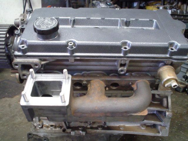

This just reminds me of another method I use to stop spinning studs and bolts(even though I didn't use it on my front brakes setup and went with the steel ring and tapped 12X1.5 holes+long HT bolts):
I drilled and tapped M5 through a bolt's head all the way to the surface area (in the picture shown is my turbo's split flange installed with head-cut bolts), this prevents the bolt from movinga nd allows easy removal of the bolt when needed(no need to tap the m12x1.5 since the small bolts lock the big ones tightly to the metal surface, I assume this can be adopted to the steel ring, disc itself or even on the hub assembly if one wants to mount the discs outboard.
note that for better balabce and clean surface one can use headless allen bolts:)

Chen,this is probably the one place you DONT want to lock the studs in....You are probably going to have to replace them often..I use a stainless stud..it does not sieze (or freeze as the yankees say...) :idea:
Stainless? I'd use regular studs from the OEM application, does stainless expand more or less with heat (never can remember that one)? If it exapnds less there will be a huge thermal expansion mismatch and possibly it will break something. :?
Maurizio
Posts: 680
Post by Maurizio »
Stainless expands less, and have had relaxation problems with stainless bolts.
For this kind of an application nickel plated 12.9 bolts, they won't sieze either.
These are 10mm studs for gods sake....How are they going to break something?? Because they are stainless ????
Relaxation of what?? the bolts,the turbo flange?? never..and they DONT sieze!! Thats the good part of using stainless...forget expansion rates with these studs..they WORK!!!
Stainless studs in cast iron manifold..

Barry wrote:These are 10mm studs for gods sake....How are they going to break something?? Because they are stainless ????
316 Stainless CTE= 18.5microm/m/degree celcius
1030 Steel CTE= 11.7
4140 steel CTE= 12.2-14.6 depending on temp range (higher rate at high temps)
Cast iron is about 12, so many different grades to choose from.
Expansion rates really are only a problem when you play with aluminium and steel, or similarly massively dissimilar metals.
Bolt seizures in high temp applications tend to more often associated with temperature driven surface corrosion between the materials, and this is where stainless bolts or brass nuts work really well :D
As for the bolt relaxation issue, because stainless bolts expand more, you now have less clamping force available at the bolt head/flange/nut, making it more likely that the bolt can be backed out, and this is most likely what you're seeing, rather than stretch.
Stretch can occur if clamping a high CTE material with a low CTE and are close to the yeild point of the bolt either to start with, or as the temperature goes up.
"As for the bolt relaxation issue, because stainless bolts expand more, you now have less clamping force available at the bolt head/flange/nut, making it more likely that the bolt can be backed out, and this is most likely what you're seeing, rather than stretch.
Stretch can occur if clamping a high CTE material with a low CTE and are close to the yeild point of the bolt either to start with, or as the temperature goes up."
Then I quickly whip out the ol 14mm modified spanner and tighten it more........... :D

On my turbo flange there in no problem removing the studs,which are actually not studs but machined steel headless bolts.
I can easily remove the 5mm allen bolts and then remove the 10mm turbo "studs" by hand, using higher grade 5mm bolts prevents them from getting stuck in the flange, also this method keeps the studs from spinning both ways , sometimes studs getting pulled out when releasing the turbo , this can't happen here.
P.S -I have put the flange and manifold's parts in a stress release oven to avoid some welding's diformation ...
