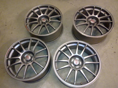

They are my favourite wheel for the 75! Well, I have a set on the shelf to fit in the future once my car is nearly finished. They are no longer a current wheel, so you will most likely need to buy secondhand/used.
The ones in the pic are 18", and I think the tyres are 215/35R18. However, that size tyre does not meet the required load index for the 3.0, so I will be fitting 225/35R18.
My wheels are OZ Racing Superleggera 18x8" 5x100 PCD, +35mm offset. I will be using 'wobble nuts' to meet the Alfa's 5x98 PCD. Centre bore is 75mm diameter, so I have 75/58.6mm hub rings. I will have them refurbished (minor gutter rash repaired, then resprayed) and painted in metallic dark grey to match the side stripe/door handle colour.
