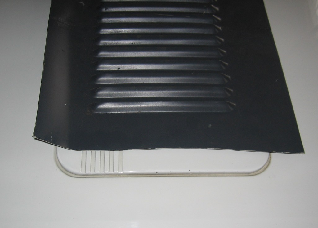

No Scoop...going with jag vent

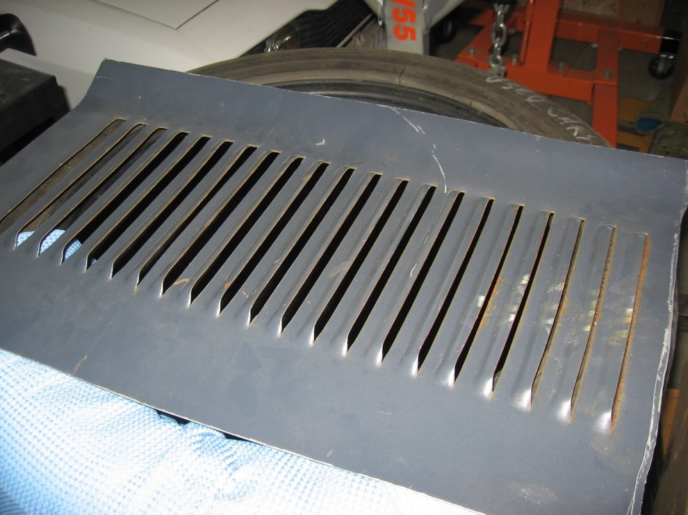

received Jag vent today....needs trimming and painting but will fit well

uhhhh is it going to look right being it has no left side vent edges due to the way the bodyline on the jag is?
shortlife: :? ?
sh0rtlife
Posts: 536
Post by sh0rtlife »
i see only 1 option..not easy but the only viable option would be to take both left and right side and cut the center of the hood side off of them set both of them in place on the gtv hole and figure out how wide you want the louvers then cut both side on an even line and weld em together........take a LONG LONG time to cut, weld, file, grind, finish, prime, fill befor they were ready to paint...not an easy task but sounds like something id do for the fun of it :lol:
or simply take both of em cut em down the middle and weld em back together leaveing you with 2 sets to work with one recessed louver opening and one protruding louver opening..either way ALOT of work...but fun type of work

I am not sure I know what you guys are talking about, Jag louvers are almost 8.5 inches wide, and with some trimming of the surround, will fit nicely.....
Which way will you put it in? Louvres up or recessed?

guess maybe that grey shot screwed with my eyes but i saw the edges of the louvers blending into the roll of the old hood and not being punched at that side
That will probably look pretty good.
