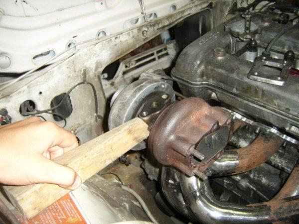

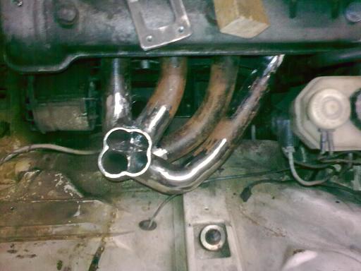

in my previous post i mentioned equal lenght manifold, its not equal lenght dont know what i was thinking :oops:
but a pic of it anyway, not the prettyist or best flowing but good enuf for my application and better than a log style manifold! :lol:
more pics to follow shortly...

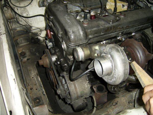

Post by BradGTV »
..... with turbo in place 8) it sits a little to high, but easily clears bonnet so should be fine .....
