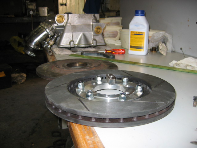

Update. Had some rear vent discs made that came out pretty well as i could not get any SZ ones. once again adding more weight but there is a 3hr endurance race coming up so trying to get prepared.

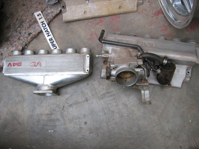

Decided to chainge the intake of plennum to the centre . Still working on a smooth lightweight pipe from throttle body tp cone filter behind headlight.
Anyone got any views on how much bigger you can go on the diameter of this pipe in relation to the throttle body if its lenght is about 500mm ?

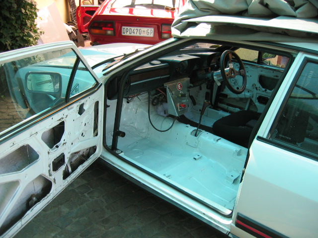

I cant find the thread but Patzo was looking for pics of a white interior. Some pics when I sprayed the car.
Kevin, 100mm I.D. is good for about 500BHP

8) cool, I've got some 90mm stormwater pipe laying around under the house, so that should give about 450bhp - that'd be almost enough :lol:

Kevin could you give us some more info on those rear rotors?

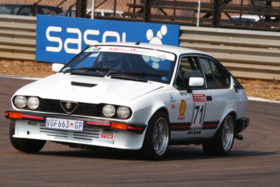

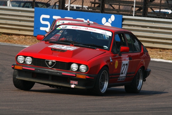

Ok, so while on subject of red and white here are some pics of our two GTV's from same position. I prefer white if the car has other colours on it like red stripe and srickers (biased). Red GTV-Conrad is taking different line defending corner while Im going in deaper before turning in.Which infact is the wrong line on this particular corner. Notice body lean of white car(Full RS suspension and 28mm torsion bars) VS red car (RS front anti roll and 28mm torsion bars).
VS RS suspension
