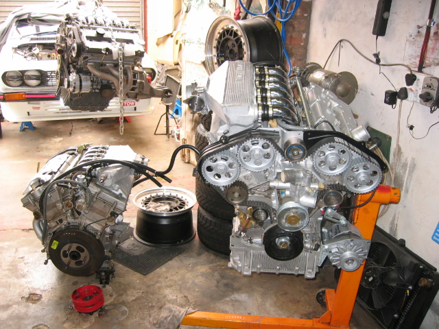

Got some pics of a second conversion I have just done for my friends race GTV. It was pretty easy as I have had all the parts from my motors . just time consuming checking every nut and bolt for condition do no stupid failures on track. Motor is standard except I put gta cams in . Definately the longest part of the conversion is the sump.

Its the engine on the stand . All the cam covers will go on but thought i would take pic in Alfas true glory.
Different size pulley on all alternators thanks Md. Also played with differnt throttle wheel sizes

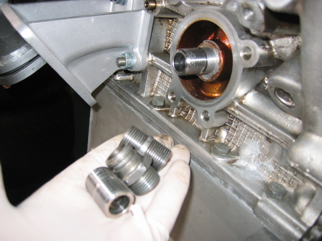

Pics of oil inserts. Beats the hell out of me why Alfa comes with two different thread sizes on the 24v motors . one thread been 20 by 1.5 pitch and the othe 16 and 3/8 's.

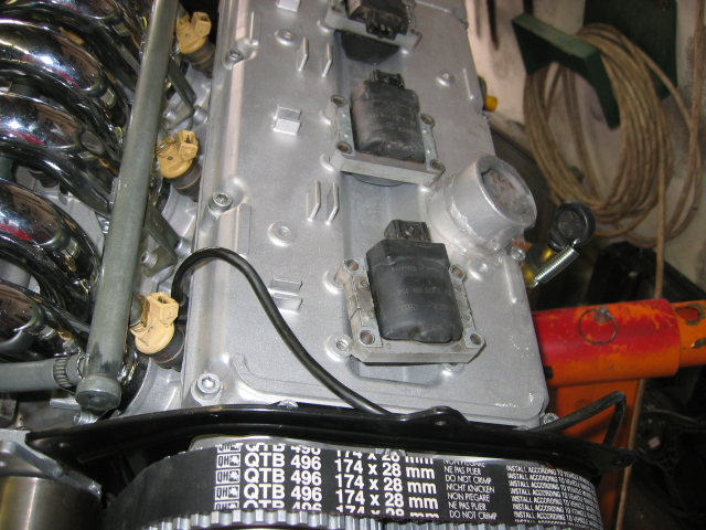

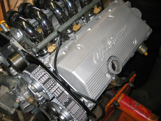

Decided to try new location on oil filler so it does not interfer with coil pack harness and keep it off the top of a cam . Also extended filler by the 30mm to make it easier to take cap on and off with covers on.

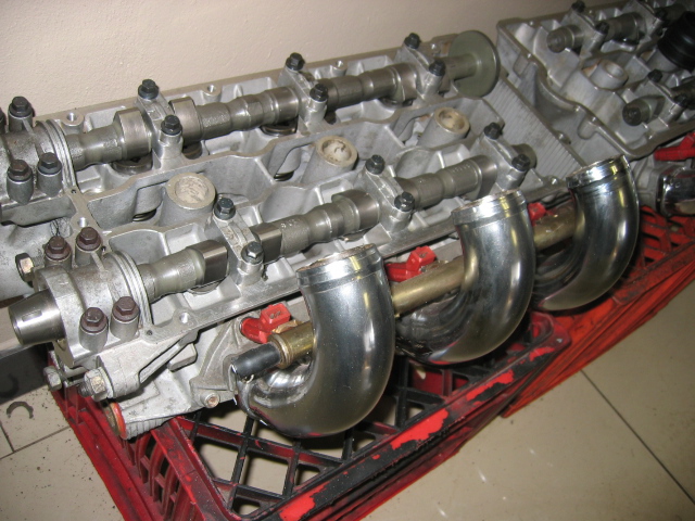

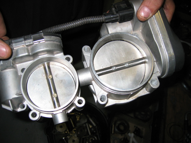

Then I went to a real workshop to see how they get real power on there 3.7's , like nearly 60kw more than mine. Check out these throttle bodies and intake runners. Note this will only work on 3.7, definately not on 3.2. Good to see Glenwood has a new and improved workshop. Some pics from there

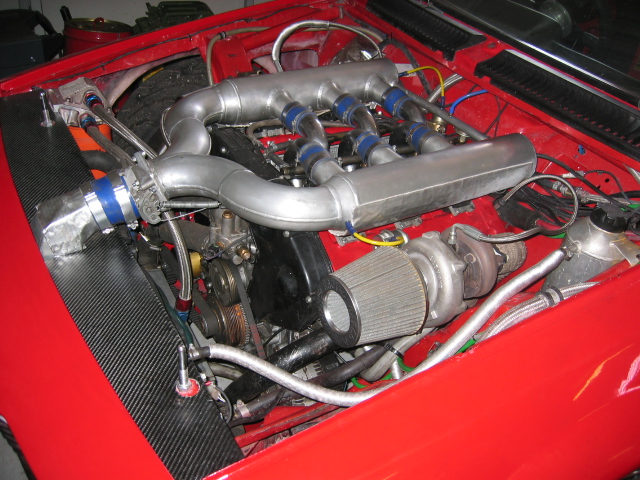

Here is a pic of now the most powerfull GTV here in SA. As comparison a standard GTA on this dyno made 138kw on wheels , E36 M3 - 156kw, my race car also 156kw, Glenwoods 3.7 210kw N/A and this 3.7 twin turbo a wacking 453kw on wheels. Thats scary stuff. Remember we are 6000ft above sea level. (no sherpas needed)

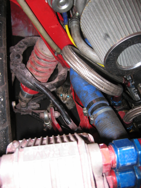

Pic of suspension on tt.
- IMG_3334.JPG (189.43 KiB) Viewed 6685 times
Re: In the build...? Anything new being done..?
Jeez, there is a kitten hiding in there. This car went out onto the track ten mins later. hope it got out.
