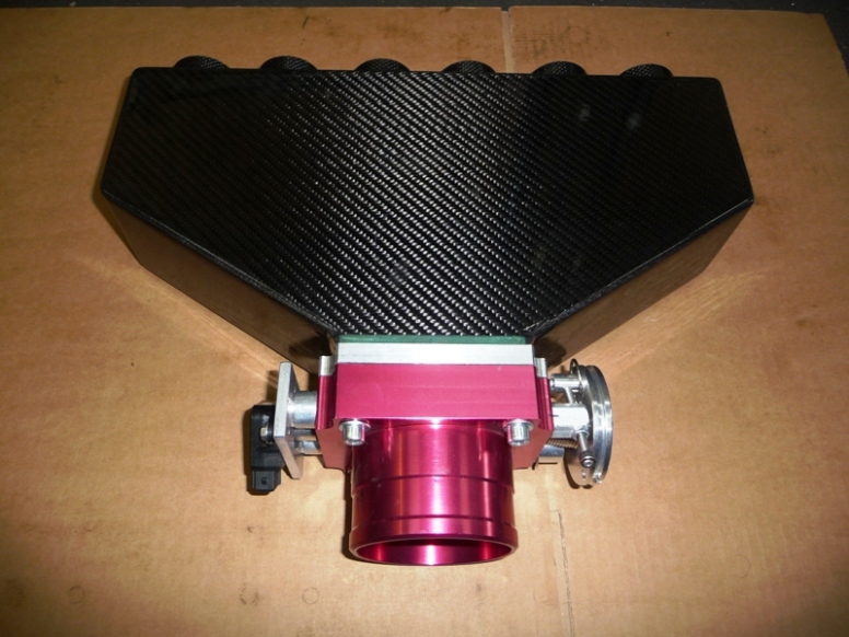

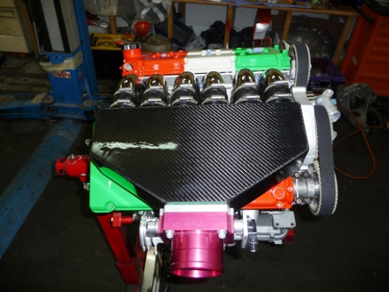

Good Evening Guys, some new pics of finished Carbon Plenum.
Already painted and now ready.
White stripes are reflexions of Neon lights !

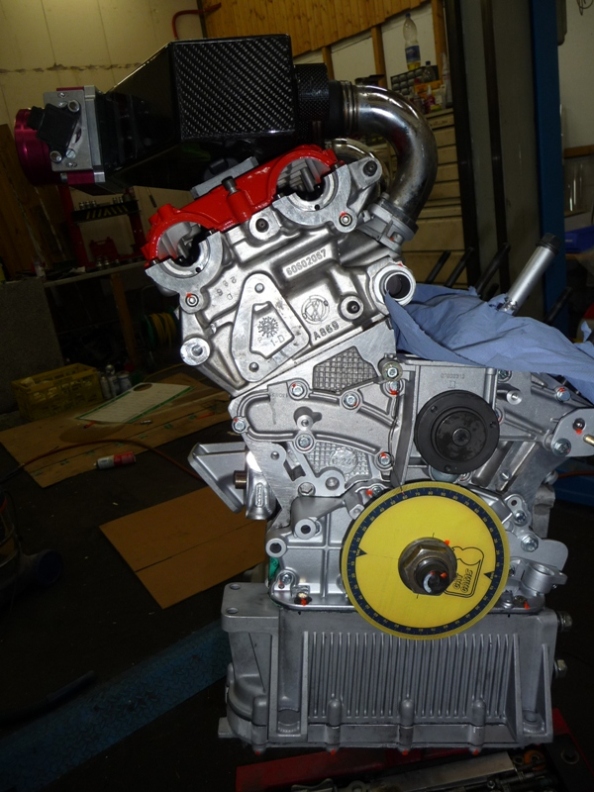

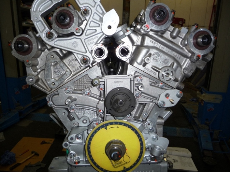

Here are some pics of the oil filter / oil cooler adapter where I´ve made a thread bolt to fix the adapter in place and it woun´t come loose during changing the oil filter and don´t loose because of the tourque force of the oil pipes / hoses.
Also assembled is now the complete oil sump including sump spacer to get enough clearance for the chain driven oil pump when using the 75 V6 sump.
Cat Cams Timing Disc is also fitted on the crank to find exact TDC Position, ... already installed is RH cylinder head and just to take a look how it fits, ... my Carbon intake plenum.

Hi Wolfgang , that's a very clever easy solution to stop the adaptor coming loose . This is a problem on these conversions as some times when you loosen a very tight oil filter you can loosen the stud out the block . The adaptor bonds to the filter and acts as a lever when you turn it loose . Unfortunately you only know the studs loose when you doing 200km/h and your car is filled with smoke from oil spraying on the exhaust . :D
Look forward to seen the pics on how you mark the cams .

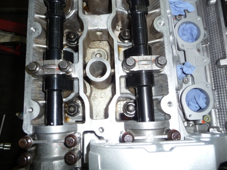

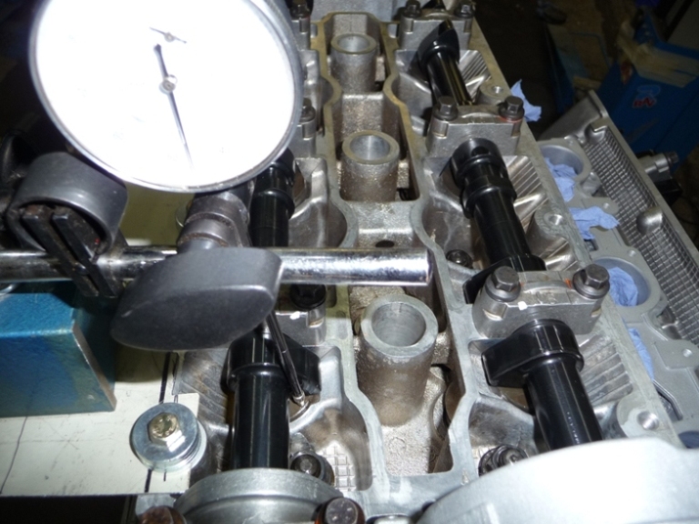

I´ve installed all cams with fine adjustments according data sheet of Cat Cams, those cams were really tricky to adjust but I´ve done it already.
Here a little describtion how I´ve done this installation and adjustments:
Before Installation of new hydraulic lifters and cams I turned back crank to a position where for sure no contact can be between pistons and valves.
I´ve taken original cam blockings of the 3,0 V6 24V, installed all 4 OEM cams to get a starting point and marked the profile on the blockings with an permanent marker.
Then I´ve installed my Cat Cam race cams with self made spacers under blockings because Cat Cams have much mor lift.
Alfa 75 Racer

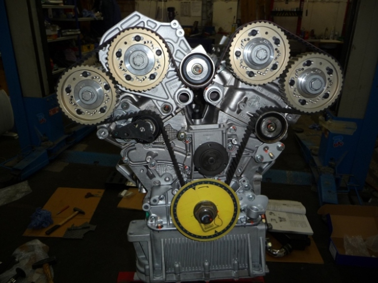

Describtion of next steps, ...

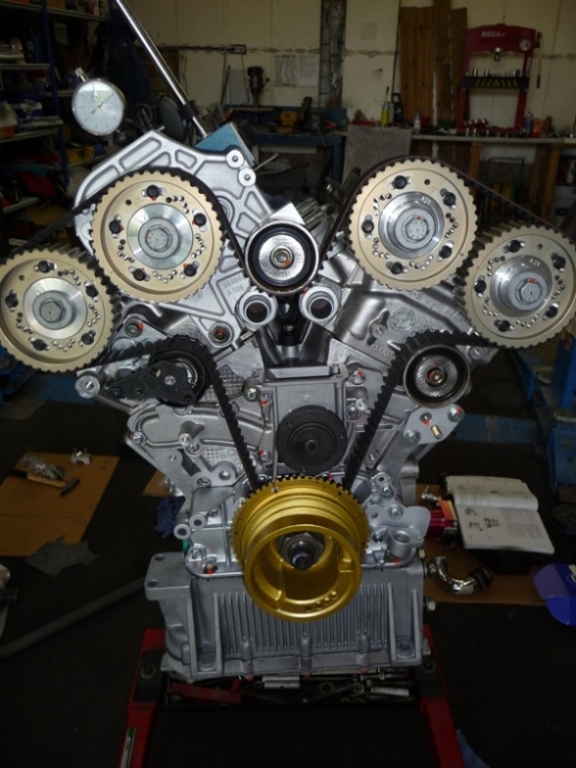

Installation of cam sealing rings and turning crank to TDC position of Cyl. 1.
Installation of adjustable cam pullies and timing belt (cam pully screws still open so cams can be turned).
Installation of Front Pully.

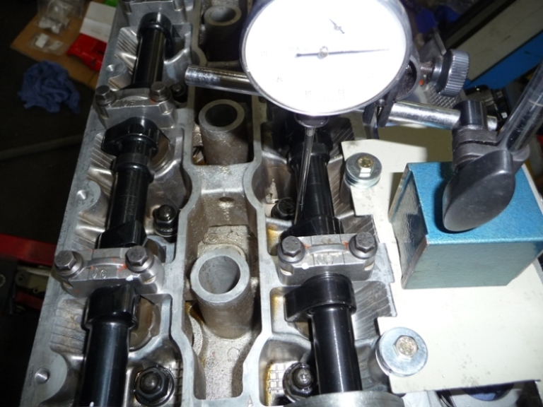

I´ve made a plate for the dial gauge which I can fit on cylinder heads on inlet and outlet sides.
I´ve started with adjustment of lift on cyl. 1 Inlet valve at TDC cyl. 1 according data sheet of Cat Cams.
Adjustment on cyl. 1 Outlet valve at TDC cyl. 1 according data sheet.

Next Steps, ...
I´ve printed out a timing disc on a self glueing folie for printers with the same ouside diameter as the front pully has on the timing disc for the crank sensor.
I´ve made some markings on cams for cyl. 1-2-3.
Next I´ve turned crank clockwise 120 Degrees to TDC position of cyl. 4 and fixed my self made plate for the dial gauge on cylinder head of cyl. 4-5-6.
Starting with Inlet valve adjustment on cyl. 4 according data sheet of Cat Cams.
Adjustment of Outlet valve on cyl. 4.

At least I´ve made some markings on pullies at TDC position of cyl. 1 so I can see from the outside if timing is O.K.

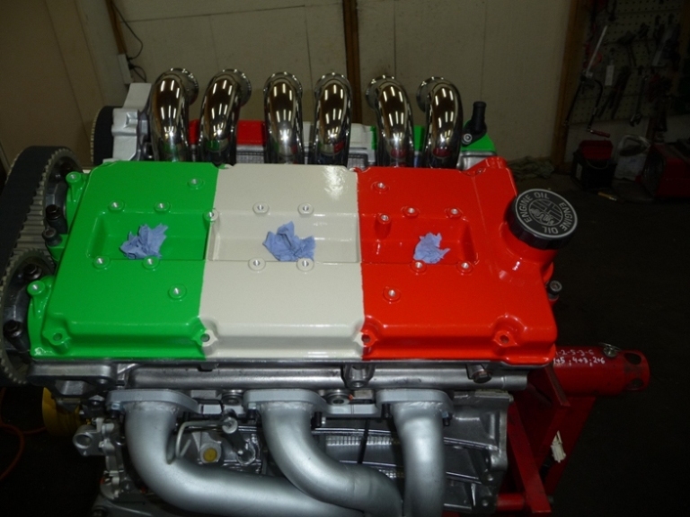

Ohhps, ... a problem came up when I first have installed "Shorties" just to check if everything is fine, ... as I´ve installd OEM 75 V6 oil stick tube, ... oil dip stick woun´t go in because of flansh of the headers, so I had to mashine flansh between cylinder 4 and 5.
Alfa 75 Racer
