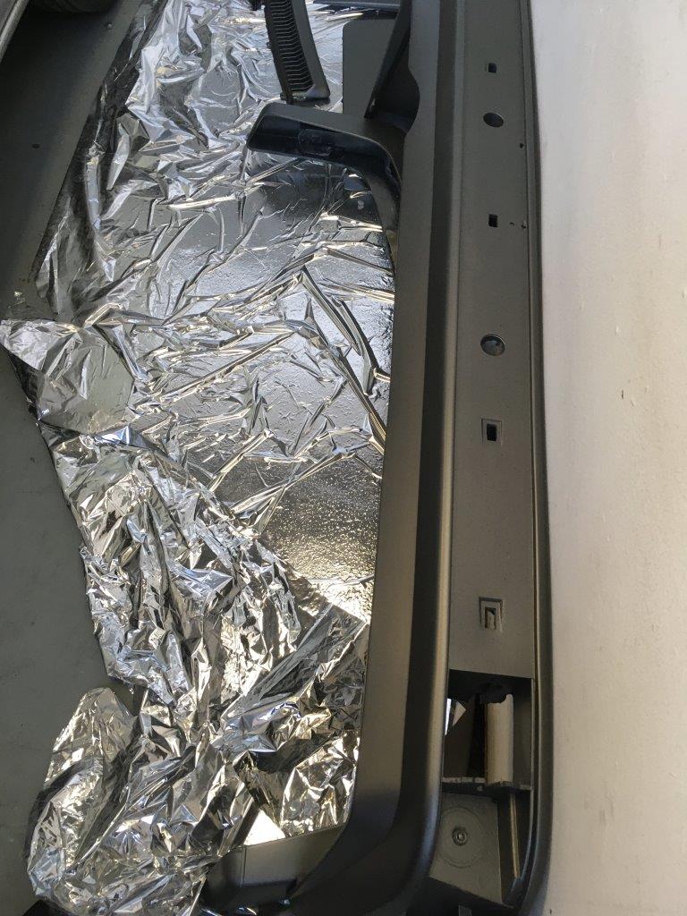

Hot air problem
A tip. In hot climates, there is a cabin heat problem from the large glasshouse. To compound the problem, the engine bay chassis rails carry the cavity heat into the dashboard and connect with the so called fresh air vents. Engine bay heat enters the holes in the rails and delivers this heat into the cabin, especially from the exhaust header side.
The fix is simple. Inject expansion foam into the chassis cavity as shown. This will ensure no blending of outside air with engine bay heat.
Air Conditioning
Down the track if you are not a total purist, avoid re-installing the useless original evaporator fan box. Alfa didn't understand air-conditioning systems then. By the time the 75 came along, they got it sorted. Install one from a 75/90 series and remember there is no actual face level ducting in these dashboards so you will have to make your own connections.
BTW. Don't listen to Kevin, his eyes are too close together. :D :D Good on you Kevin :D

Thanks MD - useful tip on the engine heat issue!
At this stage I have left the aircon out altogether (on advice of Dawie) and will try and manage without it. Lets see! :o :o

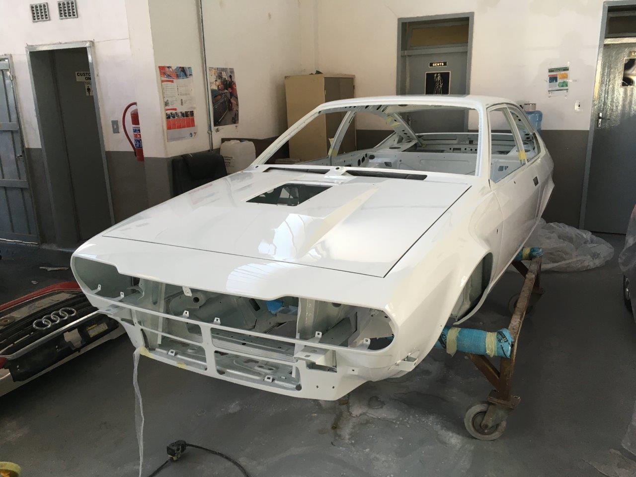

POWDERCOATING
So whilst the body was being prepared and painted, I had stripped down the rest of the suspension, transaxle, propshaft and other bits and pieces and elected to get them powder-coated.
I found Chamdor Sandblasting and Powerdercoating who took all of the parts, sandblasted them clean and then powdercoated in gloss black for me - I think this turned out very well! :D :D :D
These are the BEFORE pics:

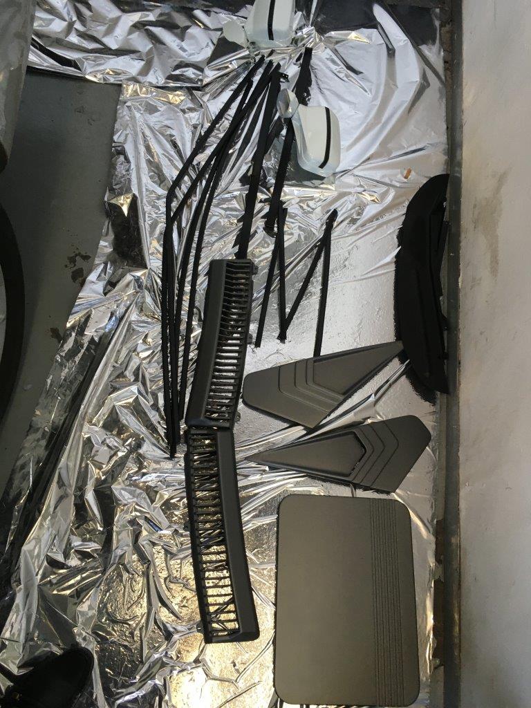

POWDERCOATING
And this is what I received back!
Believe they did an excellent job and at a very reasonable cost if you are looking for someone to provide this service.

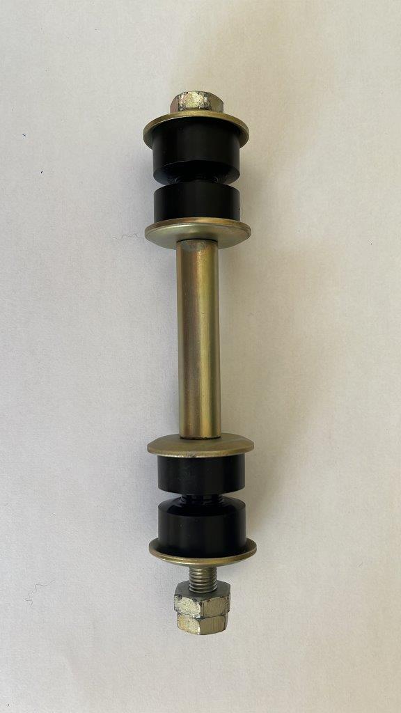

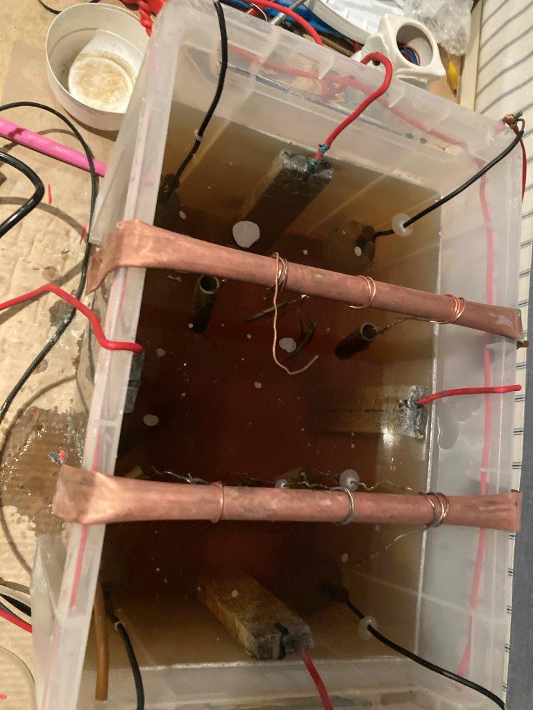

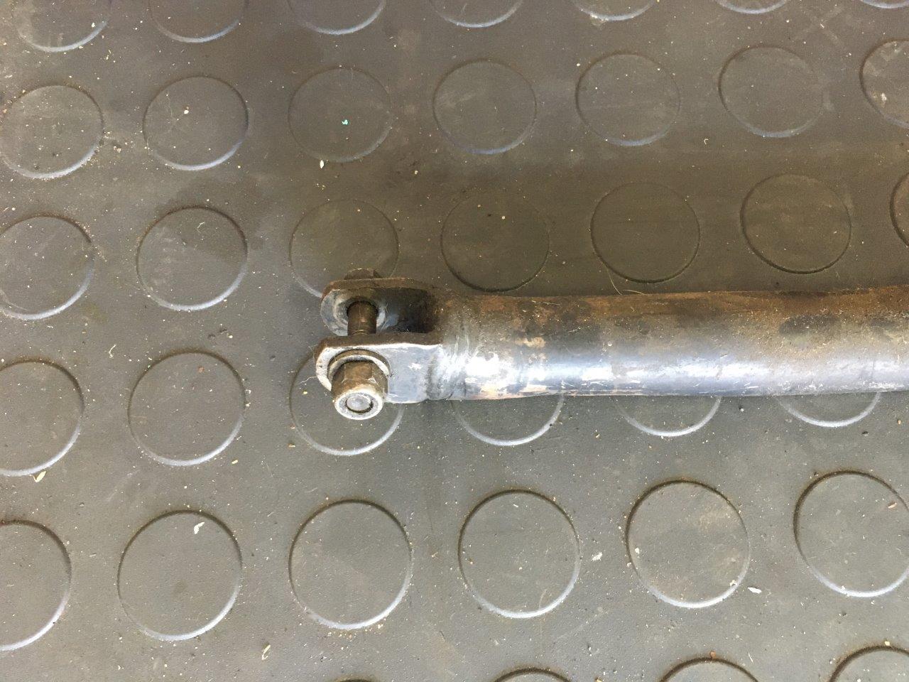

ELECTROPLATING
Wanting to ensure a real nut and bolt restoration, I had invested in a sandblasting unit from Adendorff (yes the reason they are doing so well is because of me !!! - have spent a pretty fortune there over the last while!!).
Maybe for another post but the system is not as simple to use as you may think. MANY things need to work together to have a sandblasting experience that is both efficient and effective. The most important thing is LOTS of air volume and pressure. I have a 150l W configuration compressor and quite frankly believe you should have nothing less than 200-250l and even better on 3 phase.
I have been using aluminium oxide as the substrate for the tougher cleaning and very small glass beads for the more sensitive items like aluminium.
With items nicely cleaned up, it was time to figure out how to do plating myself. This would be ZINC plating with a Yellow passivate to create not only a robust coating but also that visually appealing gold iridescent colour.
I initially made us of Tshwane Plating Suppliers to get the chemicals and zinc anodes, but more recently go to Metalchem in Edenvale.
So here is an overview of the process. IT IS TIME CONSUMING but also very satisfying!
Metalchem to get plating supplies from in Edenvale

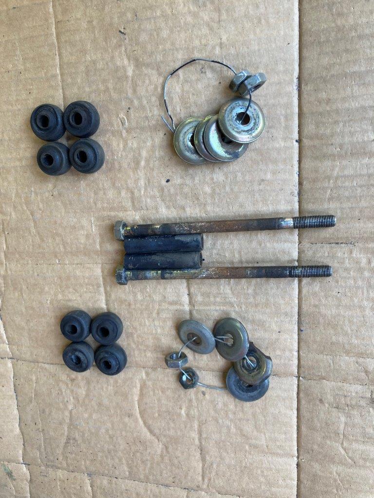

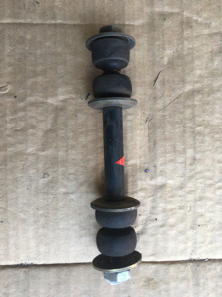

Example of item to be restored
Rear suspension bolt stripped down
Sandblasted and really cleaned up
Ready for chemical cleaning

ELECTROPLATING CONTINUED
Please read the descriptions under each picture to understand the setup and plating process
Bought plastic tank (15l) with zinc plating solution filled up
Zinc anodes placed around the tank, go to the +ve of the power source

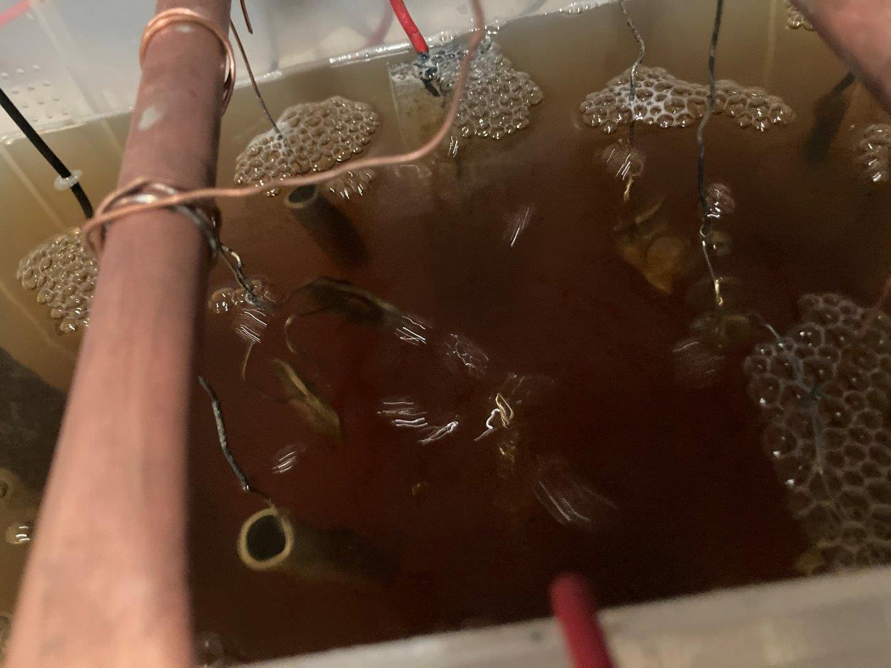

Ready to start. Copper pipes across the top, connected to -ve and this is where you hang the items using copper wire
My bench power source, can go up to 10amp, but plating usually in the 2amp to 4amp range (bigger items more current)

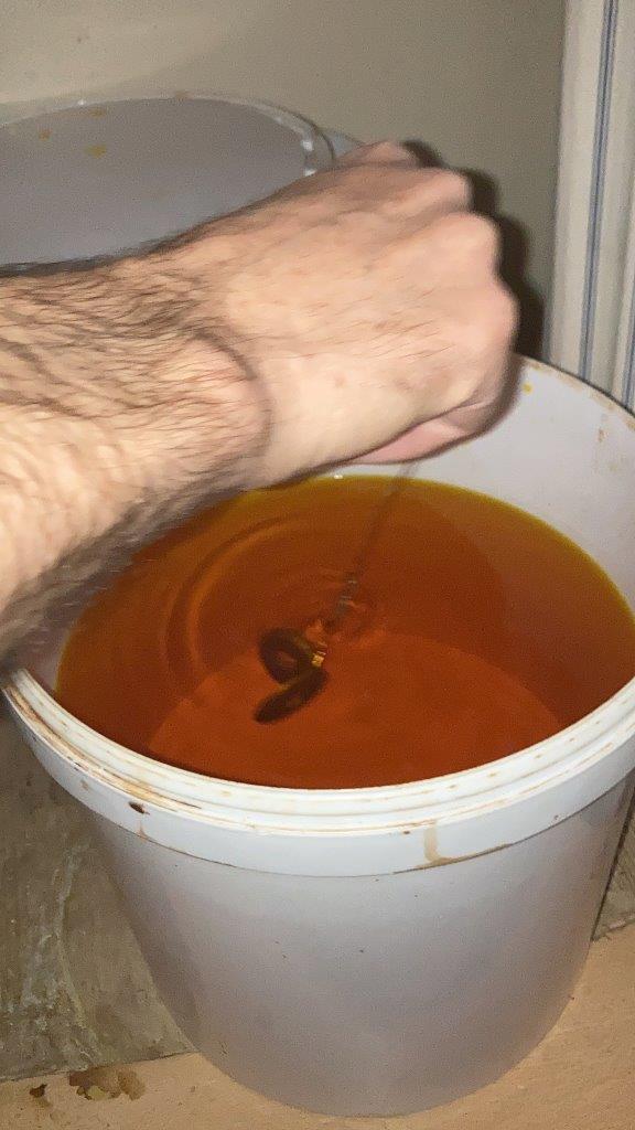

All items cleaned in a 5% HCL solution prior to plating. This chemically cleans the metal. You can see the bubbling coming off the item.

Items now being coated in the tank. Usually run for about 30 minutes.
Once completed, remove and rinse. Then rinse again in a very light acid solution

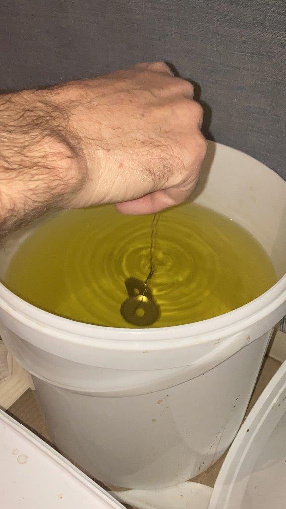

Then dipped into the yellow passivate solution. Only needs 2-4 seconds.

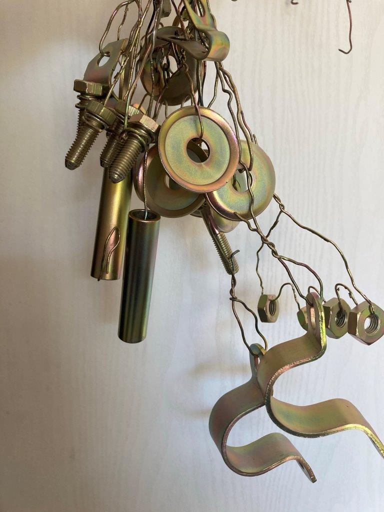

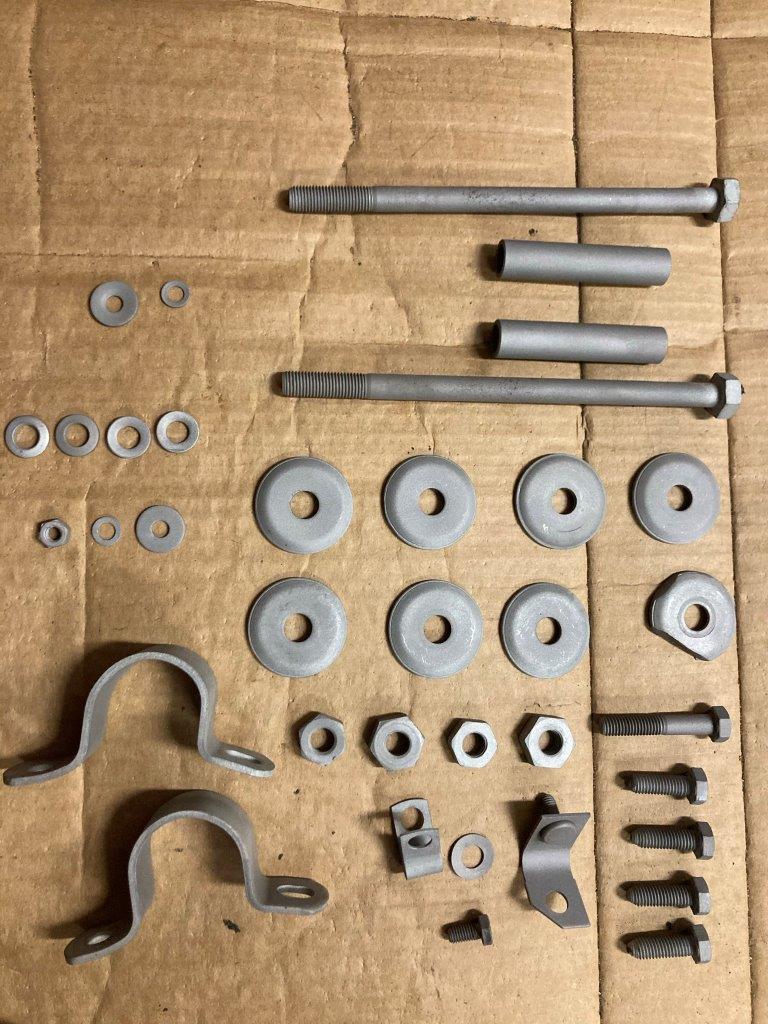

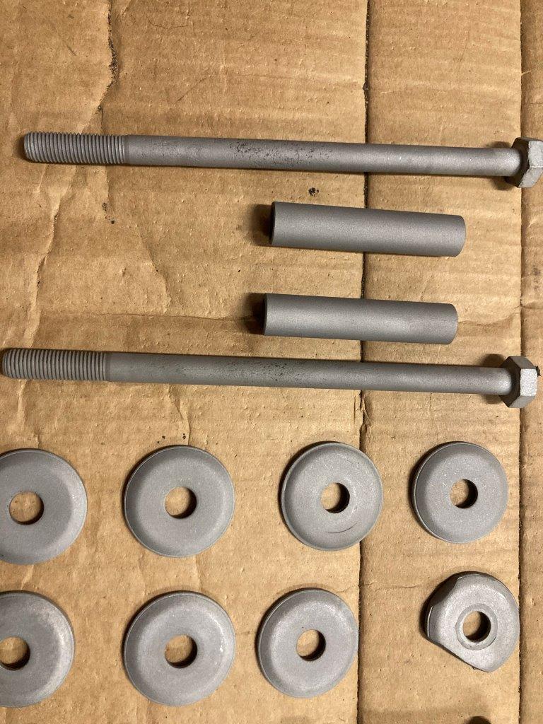

Items removed from tank and left to dry for 24 hours
Items nicely coated
Items nicely coated
Original item re-assembled

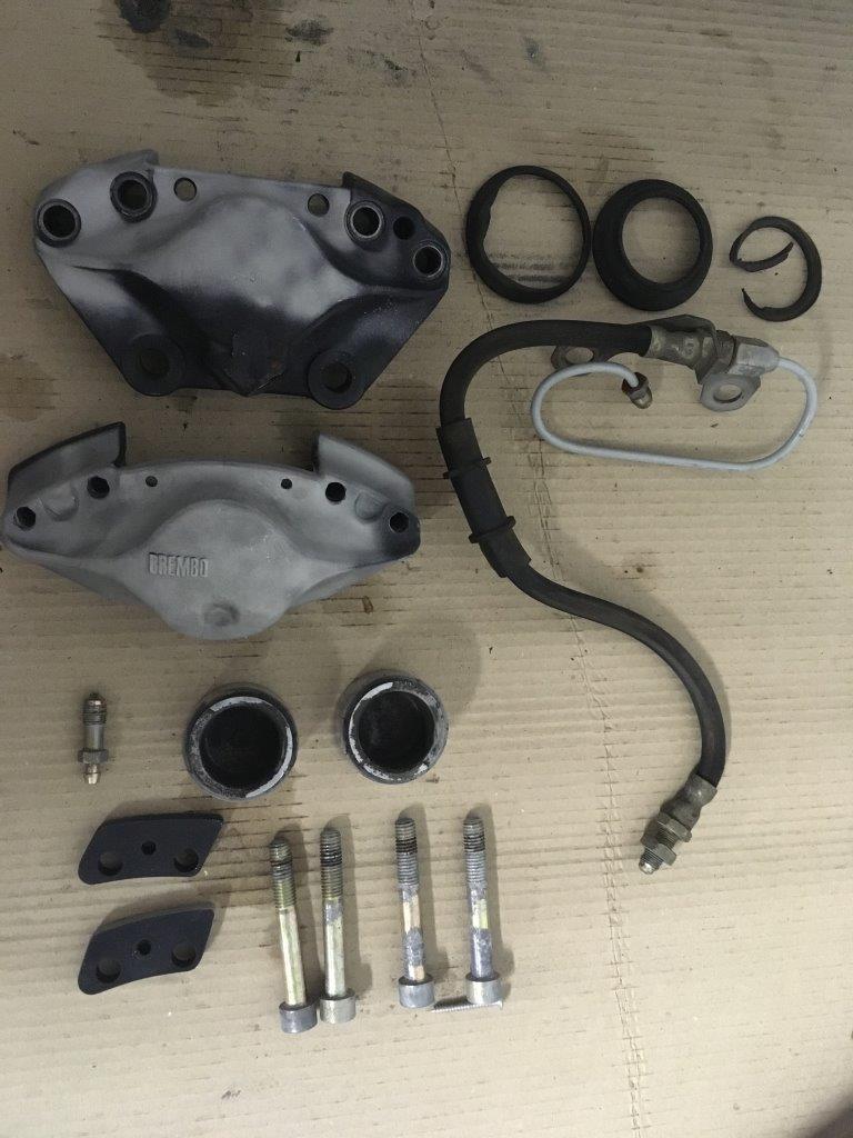

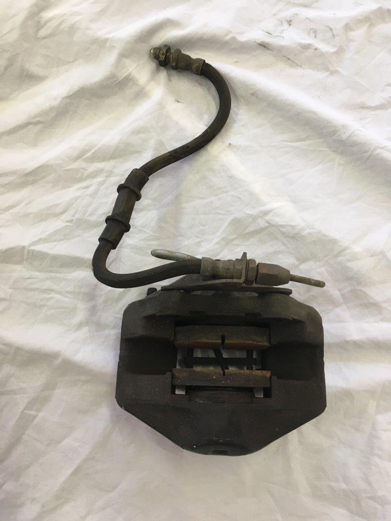

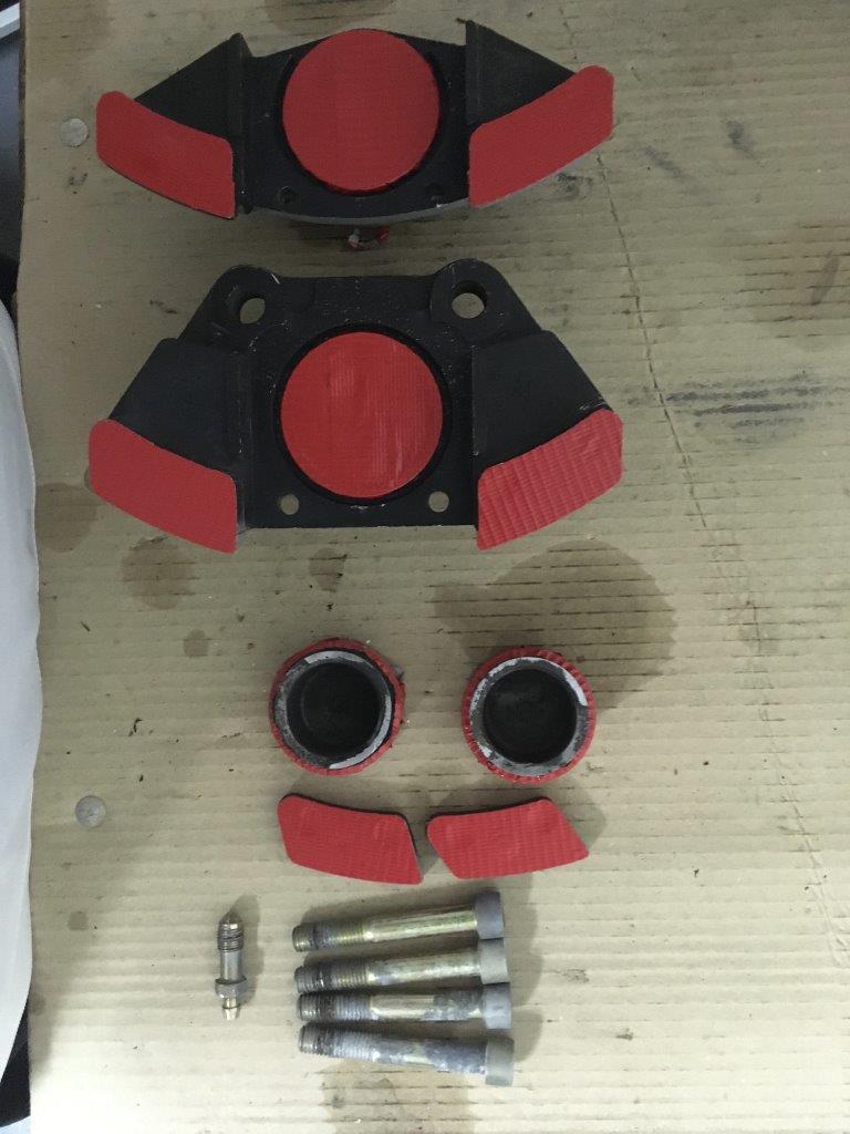

FRONT BRAKE REBUILD
The stripping and rebuild process for the brake calipers once removed needed to be done.
The calipers were removed, stripped down, sensitive parts closed off with tape and then components sand blasted, painted or plated.
The smaller rubber seals between the spacers were obtained from Summit Brake & Steering in Rivonia - contact is Frank!
I also elected to get them to strip and rebuild the brake booster - something I was not prepared to do myself.
Brake caliper off, before stripping
Brake caliper split apart

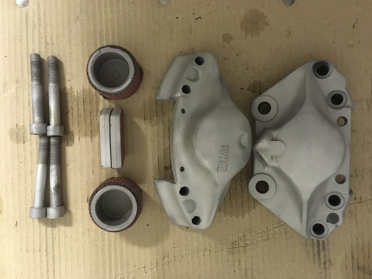

All components of the caliper stripped, ready to be restored. I did land up getting new brake pistons from Caribiner parts in Bryanston (Doug Kirkby)
Sensitive caliper areas were taped off with strong duct tape before sandblasting
All parts nice and clean before painting or plating

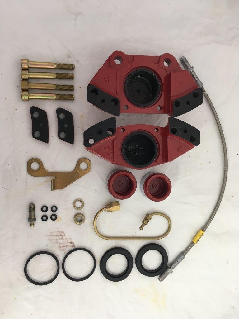

FRONT BRAKE REBUILD - Continued
Calipers painted in high heat red paint, with new brake piston fitted as well as new piston seals obtained from EB Spares in UK.
All front disc parts ready to be fully re-assembled. Note the 4 small rubber seals for the caliper spacers - these have to be the right fit. Obtained from Summit Brake & Clutch in Rivonia. These were still the original brake pistons that were replaced with new ones.
Caliper back together - ready to be fitted back onto car
Caliper installed back onto front strut. The green pads are from EBC brakes in the UK
Nicely back together and new brake discs fitted (slotted and grooved) also from EBC Brakes in the UK.
The process was repeated for the other brake caliper.
