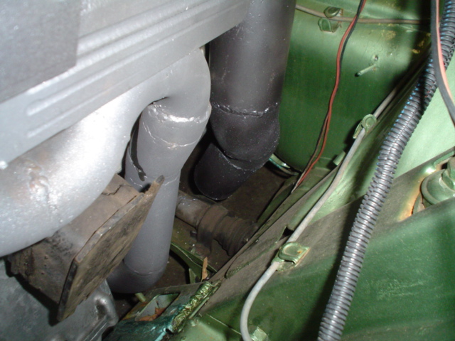

Ok,top pic,,,Firewall to downpipe(76mm)clearance..

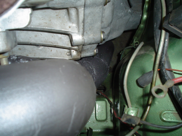

Turbo to inner fender clearance..No dummy runs here,made evrything out of the car and then fitted it first time..

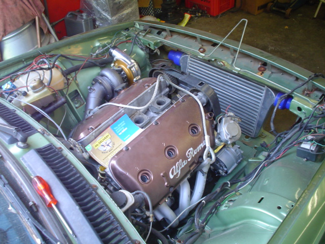

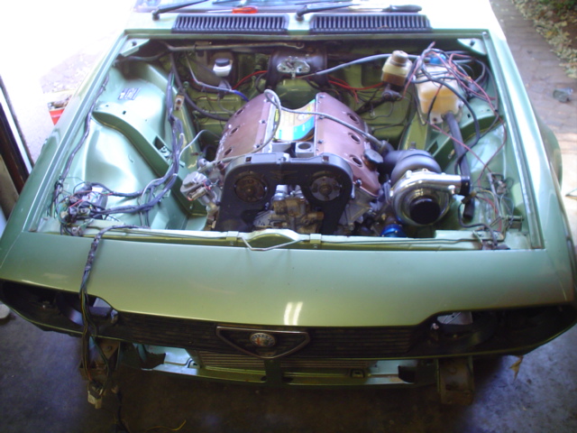

Its in..!
Yes JK,Iknow your girlfriend also says that......... :wink: :wink:

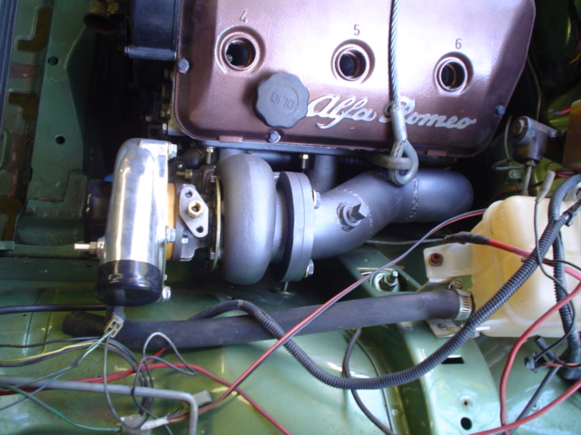

Ive used carb heads here as we dont want to break the smooth lines of the 20l bonnet/hood..
hehe, very very nice Baz, and very tight fit indeed, i'm expecting some videos once it's running please! :D
Looks great . Honeymoon fit ! Will see it tomorrow.
