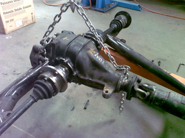

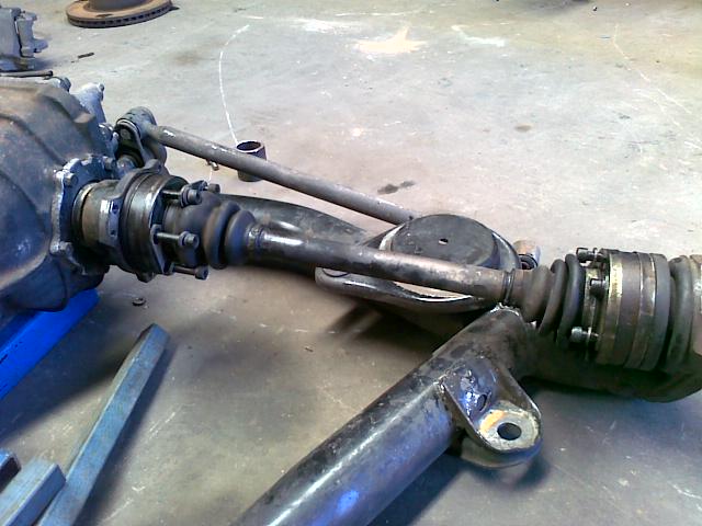

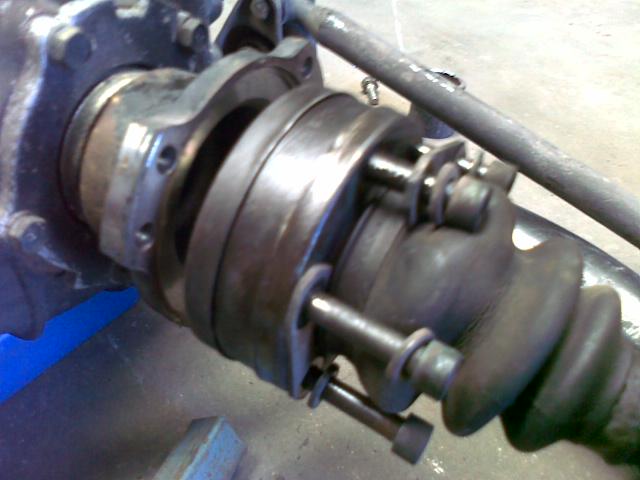

couple pics of basic set up of the s13 diff centre in the dedion, easier than i thought to do this as the driveshafts are perfect lenght when stretched, but they need and adapter which i machine to 10mm allowing the driveshafts to sit 'relaxed'. the craddle i need to make is a bit more difficult then remco's because i only 2 mountings in the front of the diff so need to pick up on the front mount and the rear to stop sideways movement.
yesterday i picked up a set of vx ss front calipers and rotors (300 x 30? mm) (lightweights, 2 piston calipers with a huge pad area) to my amazment the calipers bolt on
and the rotors fit in no worries ( not sure of offset yet, need to test with hub), any ozzies heard about these in racing situations? do they flex much ect..?
im thinking of using these on the front and vs calipers with gtv6 discs on the back. thoughts?

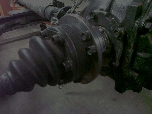

made the adapters to use the s13 diff centre with alfa driveshafts. took longer than expected cause i had to go buy a m8 x 1.00 mm tap
but they worked out spot on. next step is to set up the diff center to clear the dedion, centred and at the right height / so tail shaft is parrallel to ground then start making the craddle up.

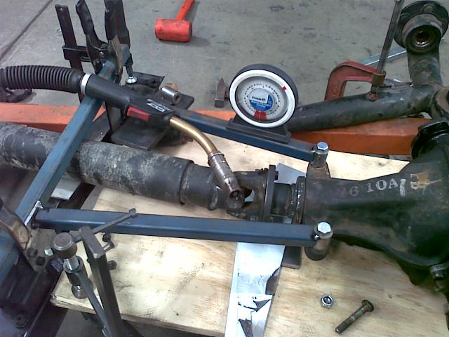

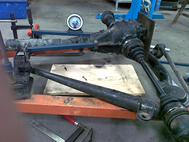

i plan to join the front mounting points with the rear making it all part and mounted by 3 rubber points. in the pics u can see the start of the craddle, took a while setting it up but is square, level and centred to 1mm. next i will make the rear plate join up the front mounts using rhs as well. i used 25x25 thick wall rhs with the bosses for extra strenght and will add a couple of braces over the driveshaft.

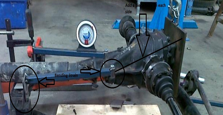

Gunna make the suggestion that you add 2 more pieces of square steel tube to keep the subframe strong and durable over time. Especially considering its a track car with strong turbo engine torque (that is multiplied in gears lower than 4th by the gearbox).
This will mean the load on the original front TA mounts and the front diff mounts will only be vertical. The way they are at in your pictures, there will be a lot of bending forces at those points when the subframe is trying to resist the torque from the diff.
If/when you have the car on a dyno and it spits out a rear wheel tractive effort (wheel torque), that same amount of torque is being opposed by the subframe and will be trying to push the nose of the diff up towards the floor of the body.
Cross drilling square tube can get some decent weight out of it too, without compromising much of its strength.

Agree with Duk in principle.
My solution is much simpler.
Get rid of the original front mounts from the crossmember altogether.
Install a captive nut in its place to take a 10mm bolt.
Fit a tube with rose joints either end to a bar like the watts links bewteen the captive nut on the crossmember and the underside of your diff. housing.
Adjust each leg to have diff. perpendicular to crossmember.
Done and dusted.
Done and dusted.

correct you are duk, good point, is fixed now
i did think about drilling 20mm holes every 50mm or so but then i would need to get it powdercoated to stop rust, the weight of the frame really isnt much so im going to leave it, thanks for the feedback
your idea is good MD, maybe in the long run would have been a better solution but after seeing remco and the rear end set up that was on ebay (the pics u sent me) i just used the rubber mounts, i will drill them and put a bolt through to stiffen them up a bit aswell.

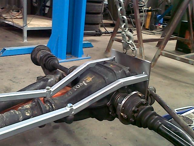

today added other braces and welded it up, still need to weld the front mounts and oxy cut the rear plate to shape then add a brace over the driveshaft, it will then be mounted under the car and the rear mount made up to suit where ever it sits.

Brad, those two extra braces serve no purpose whatsoever because the diff housing is just being duplicated.Its got all the stiffness it needs.
Re: Turbocharged 79' GTV - Track Car Build
They protect those 'mounting eyes' on the front off the diff from being ripped off as the torque tries to pull the nose of the diff up.
