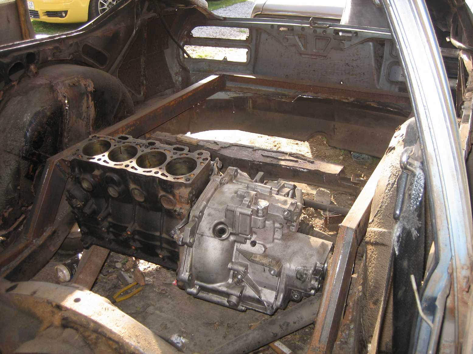

Mike,I think I mentioned this before..
Jose here weighed a whole pile of De Dion tubes and found a difference of 8kg between the lot!!Thats a bonus for free in my opinion...
This picture shaved 210kg`s from this Gtv...but I think this is rather radical..
This where your box is from btw...
