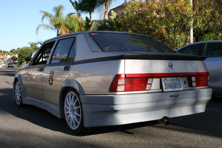

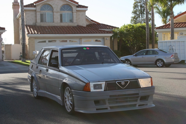

So, for this weekend's Alfa Cup race I had added a transmission oil temperature gauge to the 3.0 Milano/75 budget race car (engine + electronics out of a 164S, completely gutted). These are 20-30 min sprint races. Shifting was around < 6000 RPM with max speeds around 120 MPH in 5th. It is a 4.10 gear box with 50% lock-up, and I run Redline 75/90 NS - heel and toe + double clutching.
