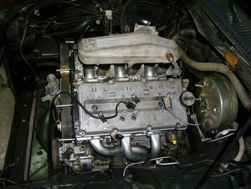

Just to inform you that we wired alfa code and started engine without any problems - key is mounted near antenna and everything works perfect.
This is how it looked yesterday:
