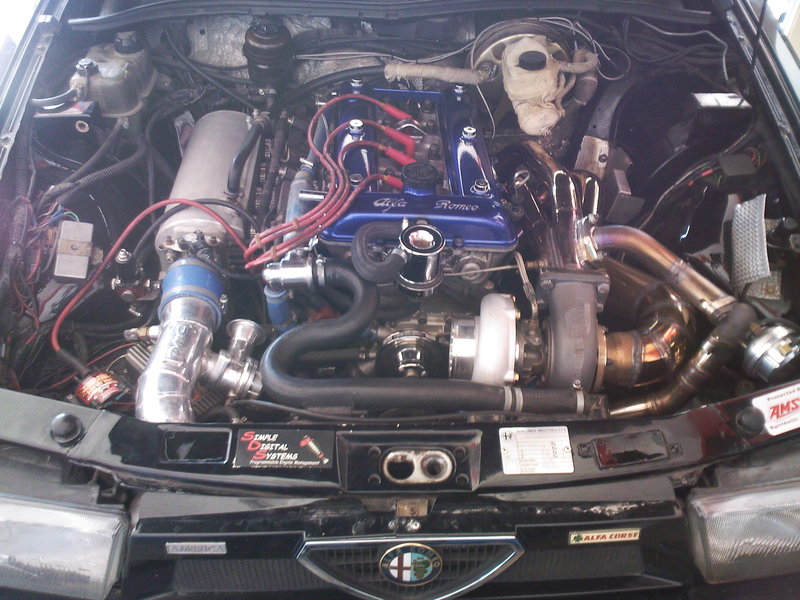

i think this is the 1.8T which Jim mentioned in the other topic.
- spa0095.jpg (118.95 KiB) Viewed 29079 times
