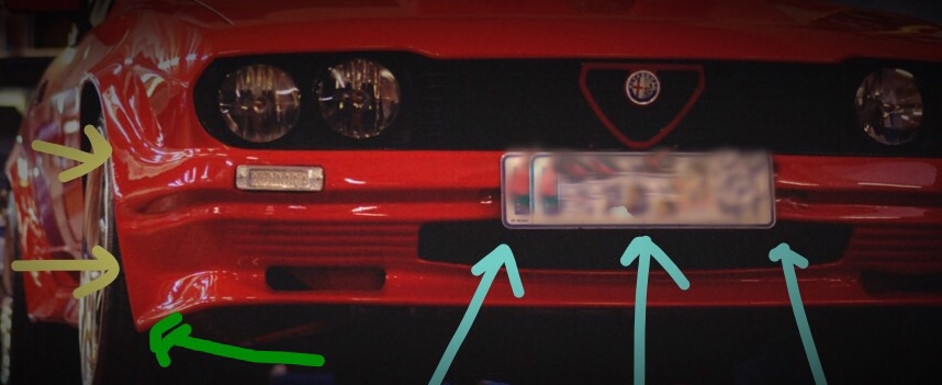

Mounts...
Blue would be the Aeroloc or quik latch locks, yellow the Dzeus fasteners and the green arrow points to the shape of the bumper I'd like to try and accentuate, hoping it removes airflow away from the front tyres....
- image.jpg (61.24 KiB) Viewed 8273 times
