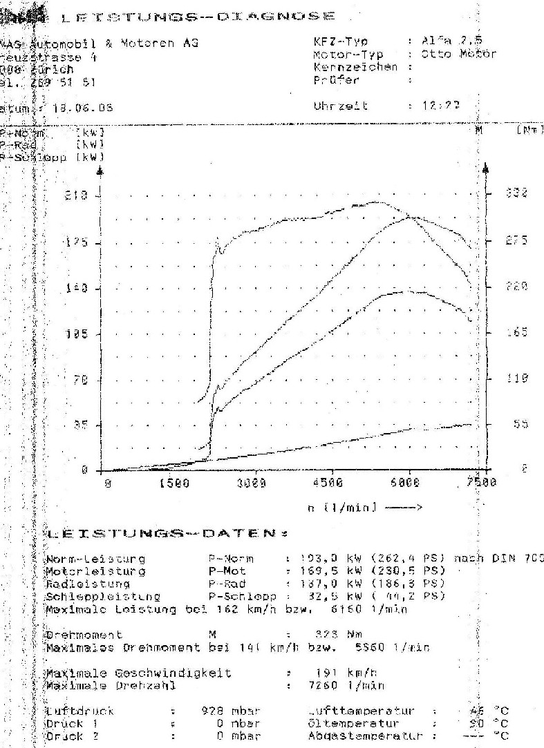

enzo
Posts: 234
Location: Switzerland
Post by enzo »
here the graph
Hmm, from the top:
-Torque
-Engine Hp
-Wheel HP
-Losses
Is that right?
323Nm??? :D daaaamn... The dyno-sheet says it's a 2.5 though. ;)
