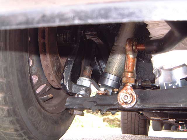

I gues you mean this little feller ?
OrMar
Exactly.

Extending down the Uprights will solve this problem without taking out the Bump stop, wont it ?
Probably, but you don't need the bumpstop anyway since the dust covers on the dampers from a 75 will have them integrated. Get those for a quick, easy, factory solution.

hmm interesting mod .... lower front whith proper lower arm geometry and high roll center+rized uper arm for camber gain... but how is this done .. i cant eplain to mayself where is balljoint :?

what is that mod?
what is that mod?

Hmm familiar picture
In the pic the balljoint is in the lower A-arm. And the upright is clamped with a bolt. This will only work with 16" or more wheels.

The Wheel is on inside-out?? :roll:

Mats wrote::shock: :lol:
yes to not rub :D .. no problem for clearance .. i have 35mm adaptor spacers 4x98 to 4x100...

35 mm won't help when using less then 16" wheels.
Haven't treid it but I don't think a car with - ET on the front wheels will be a serious hand full driving. I run SZ wheels on my daily driver and they are ET7 at the front. The car is very responsive to tracks in the road. I would say that ET7 is the max.
Putting the upright/balljoint out of the wheel is not a good idea, I wouldn't like the idea of having suspension parts touching the tarmac when I run a flat tyre.
