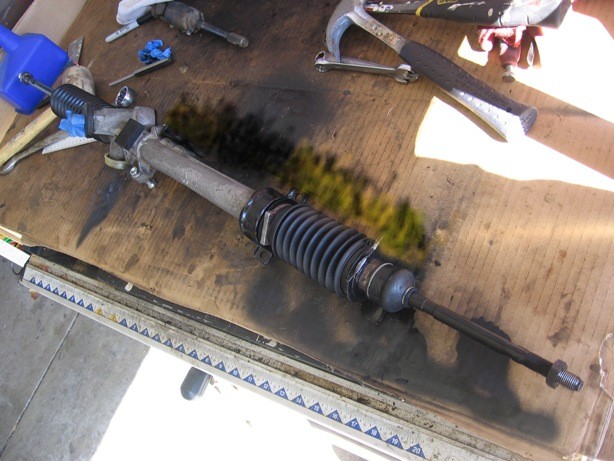

Rebuilt steering rack. No play at all. rack very nice shape (thanks Krazyman ebay)..new boots, new grease... all plastic covers and rubber like new (with a little silicone treatment) I could not find a ~32mm crow's foot locally, so I ground down a 1 1/4 in wrench...worked fine.
I can see that if you leave the stabilizer off, you can use driver side boot on both sides (IAP has both bellows, however, the passenger side one is very cheap chinese rubber, driver side is very well made. I kept the original Alfa piece just in case..)
I measured the inner tie rods..passenger side is ~1cm longer including the spacer the holds the boot. You may be able to get away with just two of the driver side inner tie rods???? I say this because it seems the passenger side is NLA....

Xrad,
WTF are you doing with that damper on the steering rack ?? !!!
That crap is only fitted to four wheek drive vehicles that are doing serious off road work like chasing sheep in paddocks. The thing is there to protect your wrist from breaking off when you suddenly hit a rock and the steering wheel gets a huge kick around unexpectedly.
If this was necessary, they would fit it around the world and on all cars like headlights. Piss it off. Its affecting your steering response.

My bmw E30 had the same shock absorber thingy... never seen it on any of my 75's without PS however.

My guess it was originally destined for the Yank market. It's just useless dead weight.

Finally we agree on something...MD wrote:Xrad,
I think you're holding back a bit though.

Ha ha. It's only taken 1739 posts !!
Don't want to be too hard on him just a small kick up the butt will do. That's cause I like the guy. He is a real doer and tries real hard to get to where he wants his car to be. Whether others agree with some steps or not is not relevant. Can't put a guy down for that.
The crap they put on cars destined for the US market is sometimes just unbelievable.

Oh my god, you guys are such sukers...Of course I put this pic in here JUST FOR YOU...I already know all about MAts and MD's thought on the freekin steering shock...BUT what you guys don't understand is that I drive with my d*ck, and I don;t want it 'snapped off'
Here is a pic of the REAL RACK..See..no shock!!!

Hey Dinky dik. I think I can see a shock absorber behind that grill.

Look closely at the rack..I just photochopped out the strut!!HAHAHAHAH

Speaking about the steering shocks I heard that the 164 with big engines benefit from it. Else it tries to pull the arms off. Didn't try my self. We removed it from my fathers 164 TS and it's at least not worse than before.
