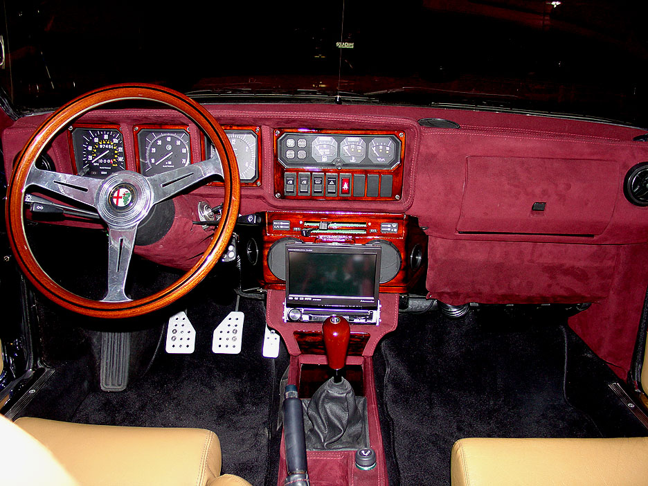

Here is a snap I took last fall. The dash is all alcantera, dark burgundy. The flash washes out the colour. At this time I still had the original seats in.

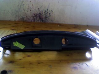

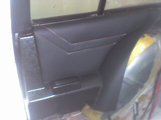

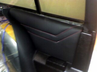

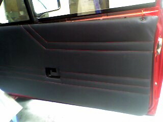

82 GTV6 Restore
Hello Everyone,
Back from the work convention and had a chance to get back on track with my project. So close and yet so far. My plan now is to finish the interior, windows installed, and Alfa registered. I will need to deal with the tweaking of the idle, clutch, brakes, starter, flanges for exhaust system, and a possible vibration with the driveshaft. All things considered this is a short tweaking list for such a restoration and now I hope to have the car running for the Montery Historic racing.
I hope to met with my associates this Sat and inventory the parts to see what is missing and pull the dash out. Joe has agreed to restore the dash with leather which was the last issue to resolve.

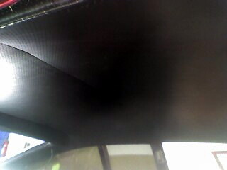

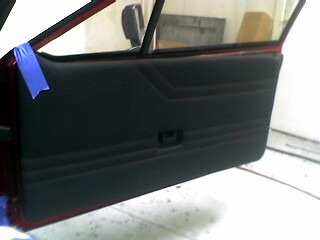

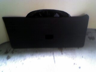

All the major parts except for the dash are done. This took longer than expected since they made all new backings for the door panels rather than cover over the old ones. I guess the old ones were too worn out and they do look better. We are just fitting the parts now and will permantly install once we determine I have all the parts. Here are some pictures:

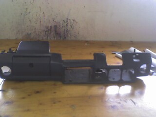

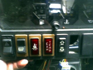

82 GTV6 Restore

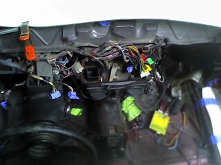

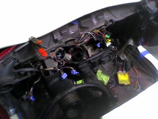

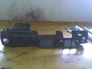

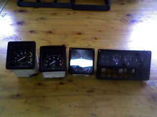

We are able to take out the dash today. It was straight forward just like the GTV6 thread explained to us. We took out the Instruments which were held in by 4 screws and unhooked the electrical wiring. We marked the wires to make sure that we did not Mix them up. Now that they are out of the Alfa I will need to bring the Speedo and Tach to a shop to fix the needles. They melted down and when my last mechanic tried to fix them he broke them off so they are short. The gauges work but we don't like the short needles. Does anyone know of a instument shop that can do this for us.
Also, I need to make sure that the tach is hooked up correctly with the new gotech wiring and change the speedo relay to the Milano now that I have Andrew's new Milano transaxle. Here are some pictures:

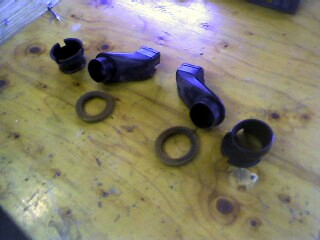

The hardest part of taking out the dash was removing the 2 bolts that were behind the top vents and removing the choke cable. We were able to take out the bottom vent tubes and then pull the top caps inside the dash to remove them. Then we had access to the 2 bolts. To remove the choke cable we removed the bolt holding the cable in place. Once this once done we were able to get the handle to pull out far enough to unscrew the 4 phillip head screws and then the whole unit came out easily. The dash was cracked alot more that we thought. I wish we could get a new one but we could not source one so restoring is the only option. Here are some pictures of the dash getting ready to be restored.

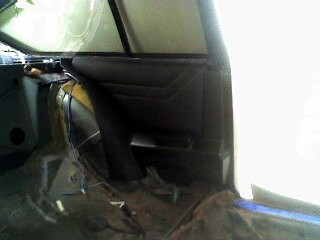

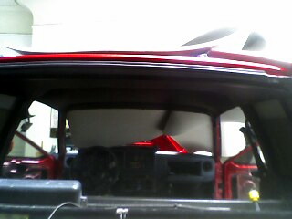

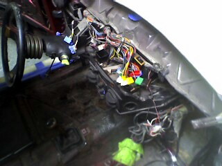

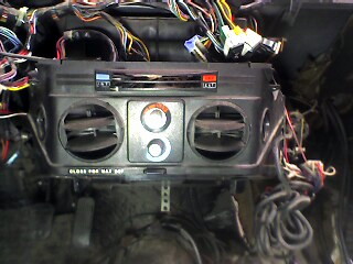

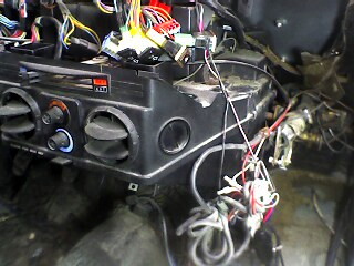

We now have full access to the heater box. We are now thinking that we do not want to restore the heater box. It looks complicated to remove and now that I think about it I do remember that this leaked one time before and we had it restored once already. Has anyone removed their heater box in their Alfa GTV6 before?
Here are some pictures of the Alfa Interior without the dash in along with the heater box.

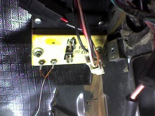

We stopped here today since our goal was to get the dash out and restored. I saw one fuse and we don't know what it is for. Does anyone know what this fuse if for?
