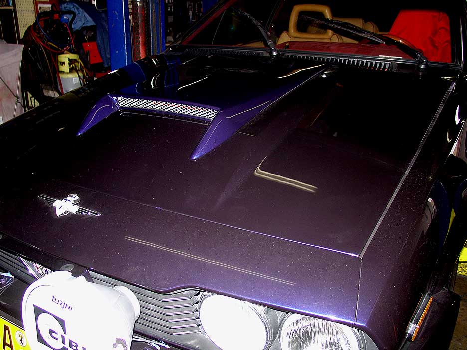

Callaway Hood Images
Post by rhodes1 »

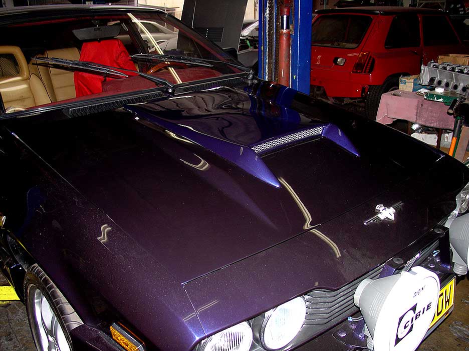

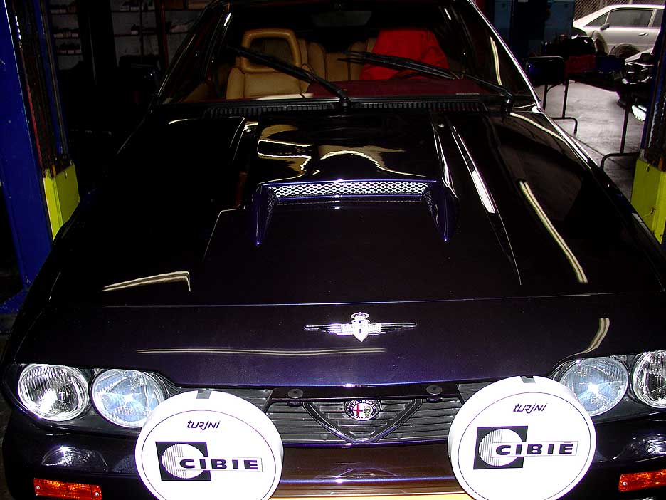

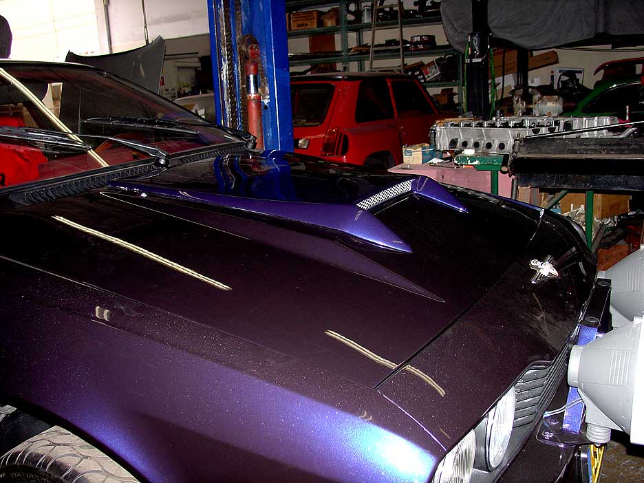

Nearing the end of the journey.
Engine in and running, transax rebuilt and installed, new brakes, rims and tyres installed, just buttoning up all the little bits.
Picked up the custom hood scoop and installed on hood. I am quite keen on it. It is not near as gross as the original and hope it looks nice enough when installed on the completed Callaway. Will be taking it down on Monday to Historic Race Engineering where I can snap proper pics of the progress.
In the meantime a couple of iPhone pics, not so good, but hope to give a general idea of it.
Cheers,
RW
looks sharp! for top mounted intercooler?
Nice work mate. She looks as though it'll be a nice ride!
Dont go rallying the thing and chip that paint though- give the jag some treatment!

Hood Scoop
Post by rhodes1 »
Hi XRad.
Yes, the Callaway intercooler is top mounted.
Cheers,
R.

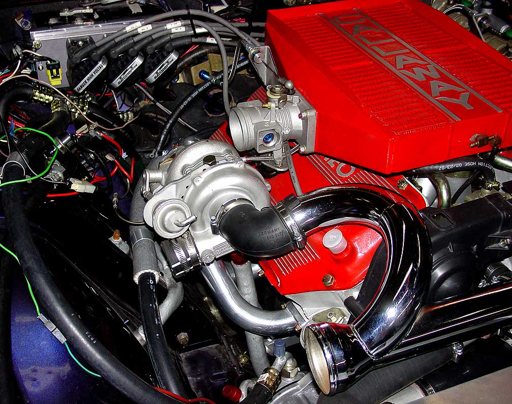

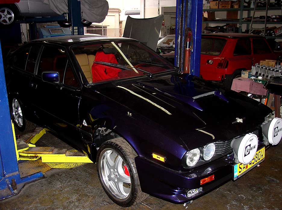

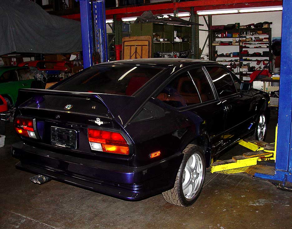

Hood Added and other progress
Post by rhodes1 »

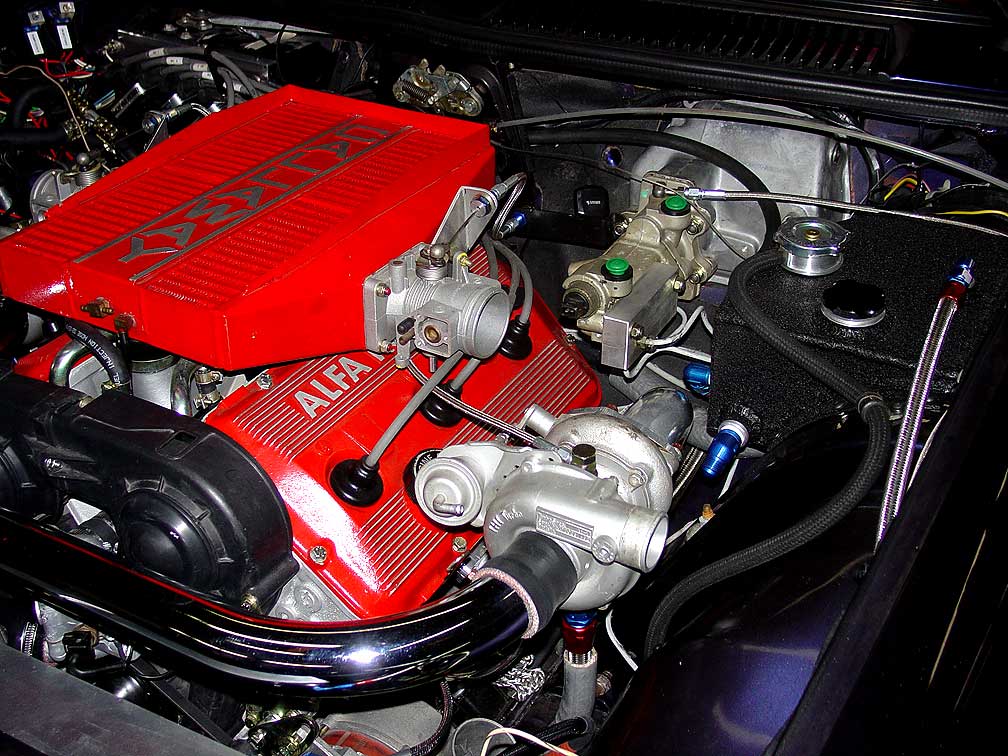

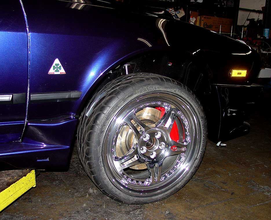

Made a trip down to the O.C. to deliver the hood to Historic Race Engineering and see how things were coming along. Making good progress, even though the car is now six months over the completion date.
As you can see from the snaps much modifications have been done and next week we'll fire up the motor for the first time since the rebuild.
We seated the hood with the new hood scoop and I very much like the look of it.
In the engine, the new a/c compressor from a Mazda 3 has been installed which will provide 30% more cool air over the TropicAir system. Brake booster installed for the Brembos from a 745i BMW. We test firtted one new HRE wheel and tyre and I love the look. Also all new plumbing and wiring installed as well as the power steering unit.
A nice treat was Martin D'Campos Callaway in for service. This is the first time I have seen it in person.
Cheers,
RW
rhodes1
Posts: 53
Joined: Wed Jul 12, 2006 10:55 am
Location: Los Angeles
More images
Post by rhodes1 »
Engine bay. Still a few bits to tiddy up.
