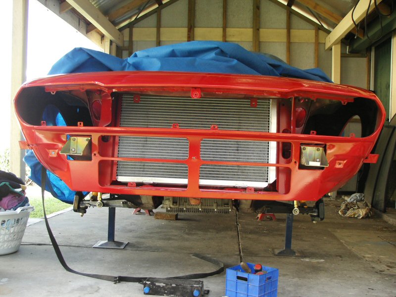

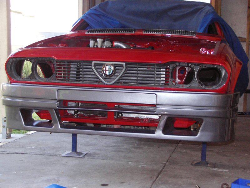

Long weekend meant a little more progress!
Bumpers on, radiator in, oil cooler mounted.
Street use front bar setup, grill in

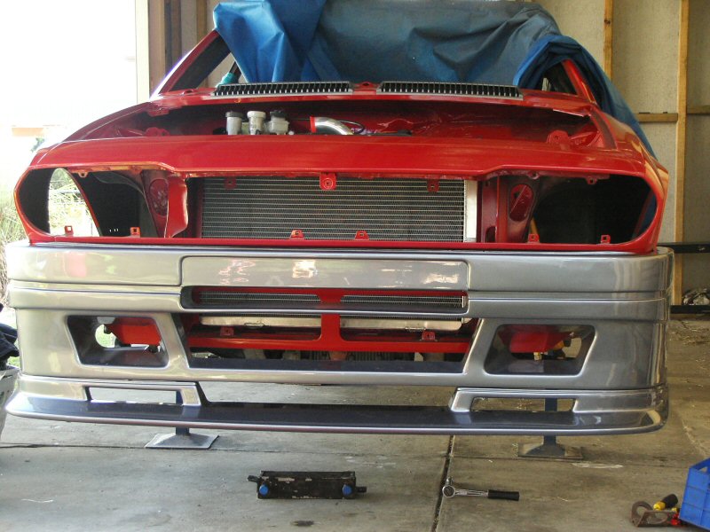

08-03-21 012.jpg (104.34 KiB) Viewed 9520 times
Front bar with lower lip for track use
08-03-21 007.jpg (101.72 KiB) Viewed 9522 times

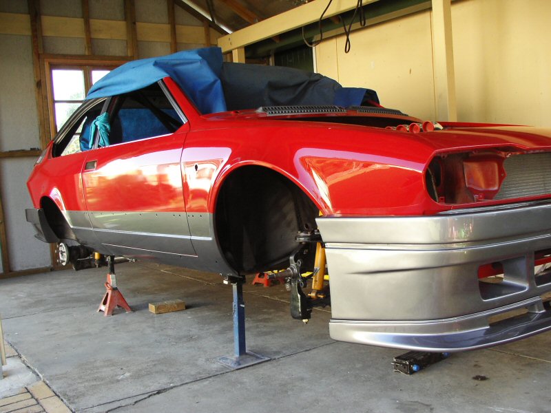

Front bar with lower lip.
08-03-21 005.jpg (111.02 KiB) Viewed 9537 times

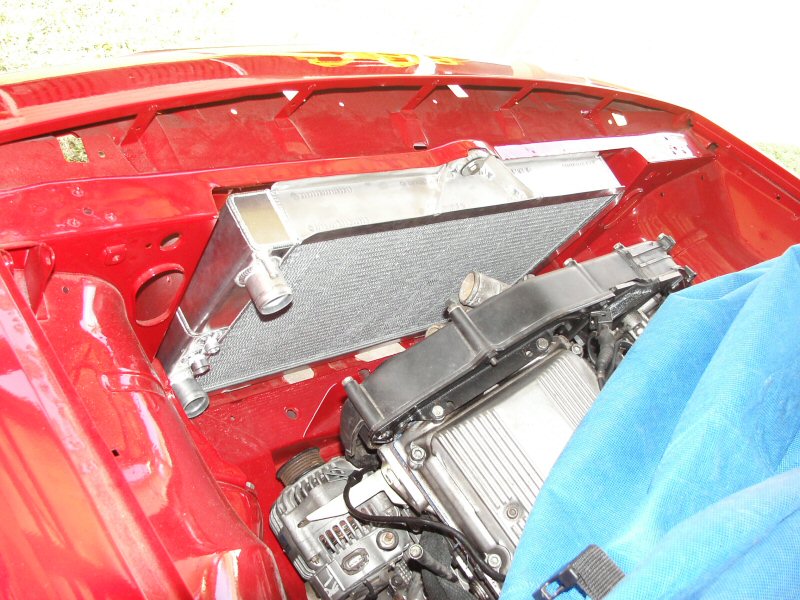

Big double pass aluminium radiator - should keep it cool.
08-03-21 002.jpg (129.37 KiB) Viewed 9511 times
Radiator fit up
Radiator fit up
08-03-21 001.jpg (118.65 KiB) Viewed 9510 times
Nice radiator. What does that front bumper come off. looks mean enough to intimidate the flying brick.

Looks like a slightly modified Evo front bar from the 75.
Looks good though!

Looks like a Serpent body kit from Mark Papadopolous?

Rookie ROX wrote:Looks like a slightly modified Evo front bar from the 75.
Looks good though!
ROCK ON
R~R
Yeah, with the ribs in the openings cut away.

Yep, it is a modified 75 Evo replica - nice and light.
Also correct - it is a Serpent one from Mark Pap.
