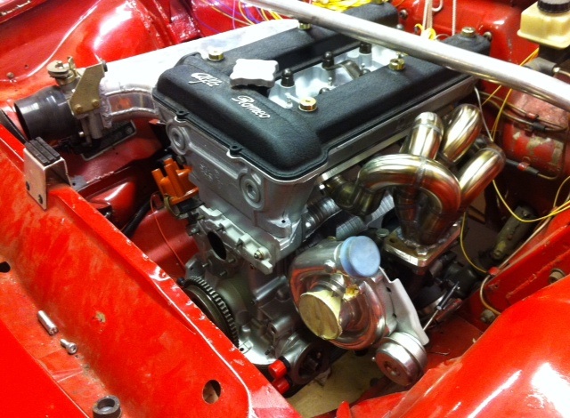

- Test fitting
- image.jpg (139.63 KiB) Viewed 7483 times

Getting there ! On the manifold exhaust flange which which bolts to head , are the holes for the studs bigger in centre ie pots 2 and 3 ie 9.5mm compared to outer pots 1 and 4 at 8 mm .
I used to have to do this on my GTV nord turbo or cut slots in the flange between the pots as the heat and expansion used to break studs . But then this was a daily driver not a racer which clocked very high mileage .
Can't believe you have to have cats on . Is that all classes of racing in Sweden
Re: Mats Strandberg (SWE)
What's the logic on the bolt holes? I could see it for the outer bolt holes being larger but the inner?
All racers except the App-K cars (FIA Historic papers). They don't last long on the tuned carb cars. They are never checked though.

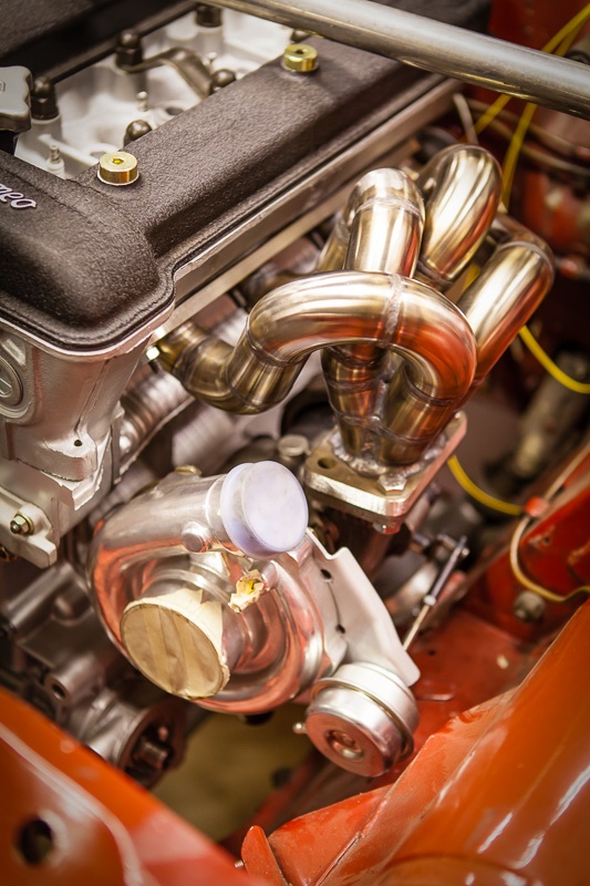

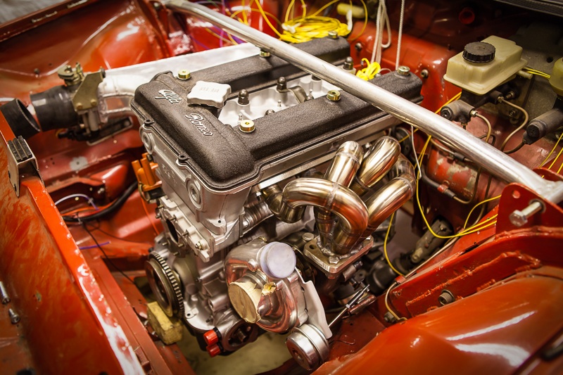

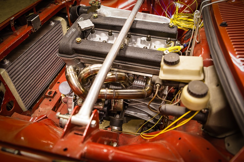

Some more pics, just showing off...
- Snug fit but it will be ok (famous last words?)
- image.jpg (139.7 KiB) Viewed 7371 times
- Detail view
- image.jpg (157.71 KiB) Viewed 7371 times
- Nice and low profile
- image.jpg (192.64 KiB) Viewed 7371 times
- Plenty of room for the downpipe
- image.jpg (186.49 KiB) Viewed 7371 times
- Overview
- image.jpg (195.21 KiB) Viewed 7371 times
