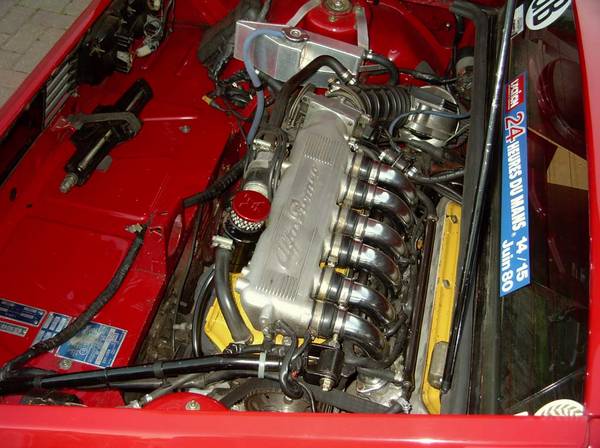

Hi Guys,
I was given a link o your site by one of the guys on the Alfa Owners site. I have a Lancia Montecarlo, which I spent a long time restoring. It has the standard Lampredi twin cam unit in it for now, but I want to fit a 3 Litre V6, like it was designed to have.
I have a friend who has already put a 12 valve in and added an Aston Martin supercharger. I don't particularly want to copy him, and his install was done about 10 years ago. I was considering the 24 valve unit, possibly using the 166 six speed box with a Q2.
That's about as far as I got. I'm not looking for massive power - low down torque is more important. I haven't written off the 12 valve idea and I'm looking for info and experiences of both types, normal aspirated and supercharged.
Couple of shots of my car at the NEC last year.
Cheers
Darren

Hi Greg,Greg Gordon wrote:Hi Darren,
That's a really nice Montecarlo. I have quite a bit of experience supercharging the 12 valve Alfa V6 and some experience supercharging the Alfa 4cylinder. You may want to check out my site.
Greg Gordon,
http://www.hiperformancestore.com
Thanks for the compliment and the link - I'll have a good read of your site. So, do you recommend the 12 valve over the 24?

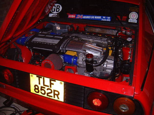

Copuple of pics of my friend's set up
Cheers
- DSCF0031.jpg (54.41 KiB) Viewed 8640 times
- PDR_0259_x2.jpg (57.99 KiB) Viewed 8641 times
Re: Hi from a Lancia Nut!!
Hi Darren:
The massive cost of the 24 valver is not in the acquisition, it's in the overhaul expense. Valve guides for a 24v Alfa engine are $45 each, and there are 24 of them. For the 12 valver they are $8 each and there are only 12 of them. That difference alone is almost enough to buy a supercharger. Factor in the cost of the extra valves and machining associated with a valve job and it adds up really fast. The entire engine is that way, the parts for the 24 valver are a lot more and there are a lot more of them to replace/remachine. I figure, best case, with the tendency of these engines to bend valves you will be dealing with this eventually.
Now I understand you may be able to find a good used 24valve engine that doesn't need to be opened up, but if it were my project I would want to start with a fresh engine.
What I said about manifolding seemed to be a little misunderstood. I didn't say anything about a side draft manifold. I was referring to the normal Fiat 2000cc intake manifold that has a single two barrel downdraft carb. They built a million of them that way, it's a common manifold. I also didn't say that was all you need. I did say you don't need to cast a manifold, I never do.
Your friends car is awesome. I love it. My point is that your car with a Fiat 2.0 and 10psi of boost will probably run away from it. A normal overhaul of a Fiat 2.0 doesn't cost too much. You won't need cams or headwork, just good pistons (the rods I am not sure about, the stock ones might be fine).
Don't forget the overall weight of the supercharged 4cyl will be a lot lower than that of the V6. This makes a difference.
I hate to keep throwing these drag race videos around, but they do demonstrate my point. A mildly souped up Alfa 3.0 is NO match for an Alfa 2.0 4cyl with 10 pounds of supercharger boost. The Fiat 2.0 has every bit as much potential. The supercharged Alfa 4cyl in this video is not only stock except for forged 8.5:1 pistons, it's camshaft overlap is set for max fuel economy not power.
