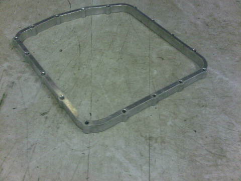

You can laser cut 20mm spacer between b;ock and sump and then cut out some webing in sump on standard sump. I did send ben some pics of spacer but cant download here unfortunately. I need to get my laptop sorted out.

Kevin, how are you getting away with a 20 mm spacer between sump and engine? won't it hit the steering rack?
I've seen some guy use the original (156 GTA) sump in his Alfetta, he just cut out a big chunk and welded a plate in to clear the steeringrack.
Not the best looking idea but it worked.

two ways of doing it - spacer between block and sump and move the steering rack, or spacer between main part of sump and bottom plate.
Here's the pic Kev sent me of the spacer plate:

Hi Kevin,
Will follow up on the 20mm spacer option. This looks good!
