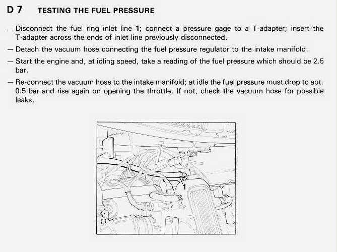

s0rr0w unless the hoses were leaking a tremendous quantity of fuel that's not likely the source of the problem.Have your mechanic do a fuel system pressure check.In doing this he should also verify correct operation of the fuel pressure regulator.

Thanx Murray.
I will ask him, if he will do the test for me..
