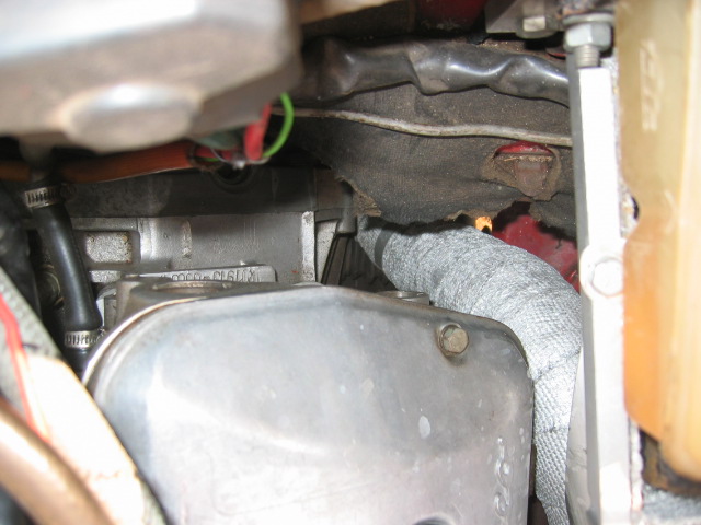

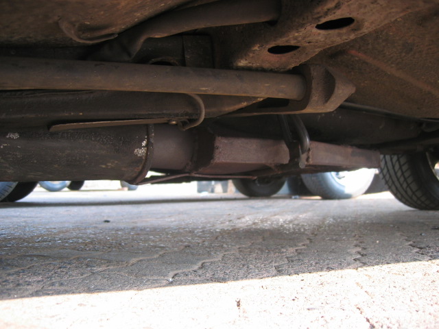

exhaust clearance is tight but perfect

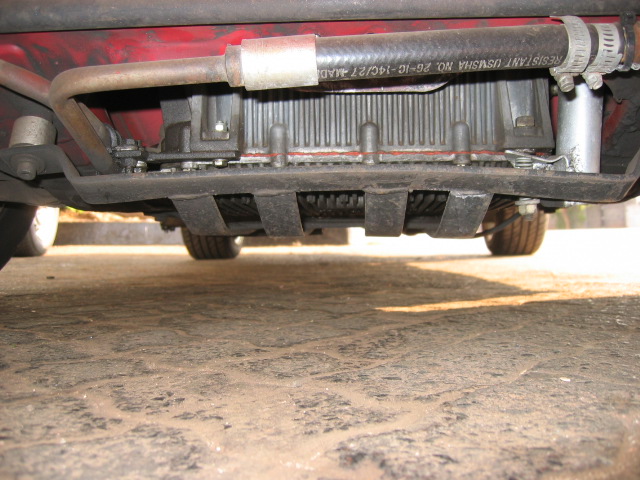

sump clearances

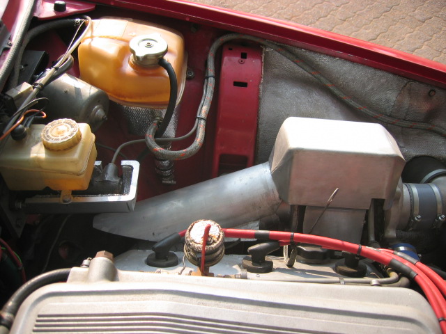

Hey Kev,Good to see Steve Schneid`s car is still alive and well!!!
This was the second ever single turbo I did after my own.As you guys can see this was pre-programmable efi or any such luxuries..She was good though-I remember seeing 240 wheel hp @ .7bar boost(6000ft elevation)

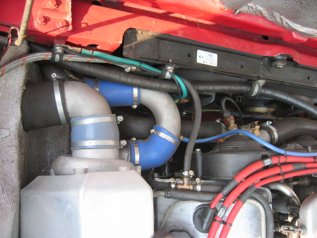

Kev,you got pics of the turbo side??

I cant find those pics, but here are three more showing how this conversion works.

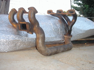

Here's a single 24v turbo manifold made for a 164S , I think it will be tauching the steering rack on the right side of a 116 though ,I may change it a little and give it a go just out of curiosity.....
In the end of the day what do you guys think about going SingleT on the V6?

Chen,
That manifold look like it's for a 24V 164, not a 164S (look at the flanges for the ports, definitely a DOHC port). Unless by 164S you mean a 164QV 24V?
As far as 2X turbo or not, I think single turbo is much easier, but performance....well can't be as good as 2 turbos. If you get 240 bhp from 1 turbo, maybe you can get 270 from 2 small turbos with less lag.

Sorry for the confusion , here the 164 24v is called a 164 SUPER, I thought 164S is the same thing...., anyway it was working fine on a 1994 164 24v with an old school T3\4 hybrid , will fit a 24v longi' transplanted with a slight change on the connection flange(have it directed more to the front of the engine bay so it wouldn't tauch the steering rack and engine mount.
