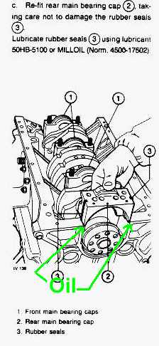

I dont use seals at all,Force that lovely grey silicone sealer in the holes and make sure it peels out on the inside join all the way from top to bottom.It also squirls out at the bottom outwards..

Alternatively,remove ciggy seals in place(man,im glad this is not me...)clean with solvent,and fill with loctite gray silicone-leave the ciggy seals out..

So Barry based on what you said,once I flip my engine and haul out the bearing cap I should yank out the cigarette seals and use only Locktite 510 sealant (or similar) ?

Yes,leave the ciggy seal out completely--fill it with that great Loctite gray silicone that GM use while they re still in bussiness!!!
Make sure it seeps out the joins as in the pic.On the flywheel side it must also seep out..Then NOTHING gets through there..
