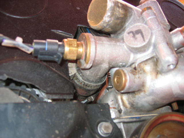

i could use a pic of the ass end of a 164 3l 24v. i got a 2.5l 24v pic but it is from the 166 and it has the coolant in the back. i am trying to get a local company on board to make that transmission adaptor and i do not want them to get scared away. post them up and please make some suggestions about getting this plate fabbed up.

These pics of the thermostat on a 156 based motor(chain driven pump).
might help. Still looking for the others though.

You can off set the "pipe - tube"(the one that screws into the block) by rewelding it to its threaded housing but you are not guaranteed it will turn to the correct position or you can do it the proper waylike Barry does it and cuts the one tube off the thermostat housing and reweld it in the correct position. May be he might post a pic of that. Not that difficult if you have the correct weldind equipment.
Oh sh#t, posted the the wrong pics. The pics of the Getrag box fitted does not show clearly but it will help you get on the correct path. Sorry about that.
