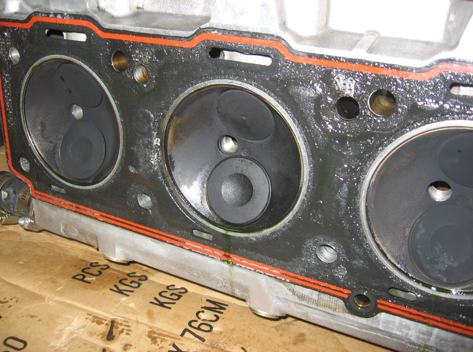

Mats: looks like you were right......I did not see it at first but look at the #5 cylinder in the pic below. You can see the leak and the head gasket distortion....(you can see corrosion in the #5 bowl as well)
Time to get my head milled...
I guess the head is a little warped so I put another on to see what happens (with a new gasket)

New head on, started right up, no more pressure in the coolant bottle (I should have recognized it), no more antifreeze out exhaust!!
Torqued to 76ft lbs per manual. For some reason, I think I only did it to 65ft lbs last time.....?
