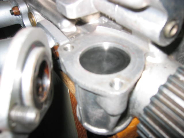

I want to dispense with the distributor because I'll be running an EDIS ignition system.
Problem is that the little gear drive is held down by the dizzy so without one it will simply ride up and then I won't have a oil pump dive.
So here is what I've done so far.
The bearing is a 12X26mm thrust bearing.
There is about 0.5mm end play on the gear and I think this is enough to allow for thermo expansion etc. I presume that under load the gear will tend to ride up to meet the trust bearing.
So if anyone can see a flaw in my plans or suggest any improvements then please let me know.
Brett

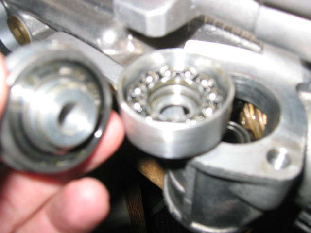

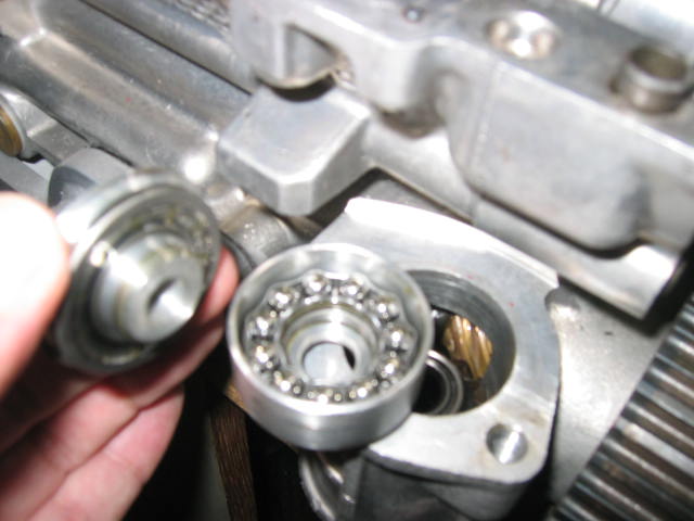

Barry, made pretty much identical part for onr of my motors. I will pull it out and post pics of any wear. I use nylon spacer on top. It has worked for 5000km sofar and I think its bullet proof. It was a clever solution as I used to have a nyloc nut on top with a washer before. If that nut comes loose there goes your engine.

Got some pics. I did find a nice coating of oil on the bearings and no wear sofar. See the pics

Geez that looks similar to what I came up with today.
Any problems, signs or wear, bearing chatter etc, plenty of oil in that area?
I made it out of the head of a 1 inch stainless bolt.
I have yet to machine down the aluminium plug to suit.
Anyone got any ideas of how to set some sort of preload spring tension?
I've been toying with the idea of an oring set into the end of the plag where it mates against the bearing.
I will drill a hole down through the plug and fit an 1/8 hose fitting to the top. Then I can connect a line from the oil separator as slyalfa suggested.
