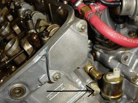

Seb,
The 3.0L should have a low oil pressure sender beneath the original distributor hole. At least I think that what it's for as I don't use it. Hook up a bulb to the sender and see if it lights up or use the hole with appropriate fittings to fit an oil pressure guage.

Ok david, thanks!
But Your 3.0, is it a QV or a regular 3.0? Only the QV:s has the oiljets for the pistons and the different gear for the pump. The regular 3.0´s has the same pump speed as the 2.5´s, if my info is accurate.
The low oil pressure sender your´e pointing to, is it for the varning lamp in the dash?

Seb,you want real life figures here-not just a lamp that inicates on/off..
Fit the master mechanical gauge and see where you are-its the only way..........once you have determined the status you can decide where to go from there.....
David,I know your trying to help,dont mean to shoot you down,mate.....the light indicator probably has a knee pressure of 0.2 to 0.8 bar only-this is no good in figuring out if its a sender unit or the pump and related hardware......
