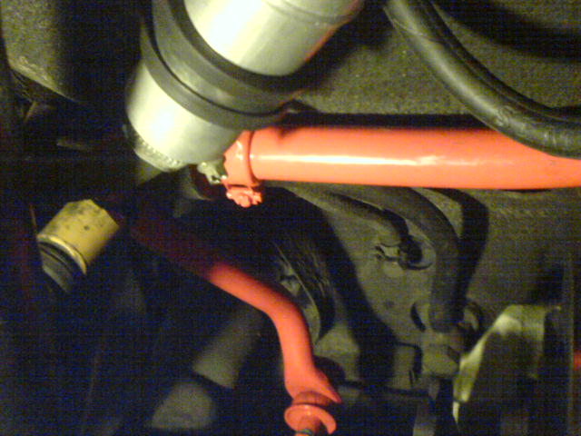

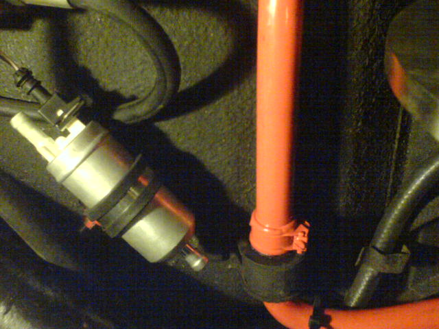

Few pics of the low pressure pump (0,24bar 75l/h), still waiting for the new efi pump.

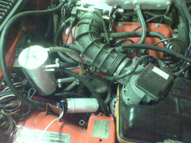

Well it's 12:30 AM here and ...
Honestly I didn't think she was going to start - i mean there ALWAYS has to be something, add to that a 164 alternator conversion - something really had to go wrong.
Ok so final checks, few looks at terminals on new pump, back into the car. First i cranked it for 20 sec to make sure that the surge tank and EFI pump was primed. Everything's connected I turn the key, one rev of the crank... second... third... cylinders one after another fire up and maintain stable idle! After 4 months!
runs smooth, revs excellent. I just need to hook up pressure gauge to monitor how it really works - so far 15 mins of running and everything is good.
Unfortunately theres a micro fissure on one of the welds on the surge tank - will need to fix that.
Heres the pic of still mock set up, but hell it works :D
Test drive next week, ill let you know how it performs in battle mode :twisted:

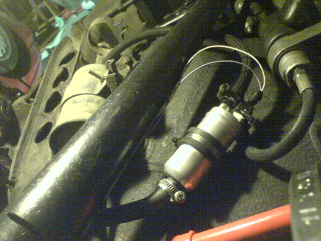

Just thought I'll post pics of finished setup. Thermal shielding still to come... Test driven the setup and 100% satisfaction so far :D
Painted the tank jet-black, looks almost stock, huh? :D
I even made 'surge tank warning stickers' to avoid unnecesary questions during MOT :lol:
