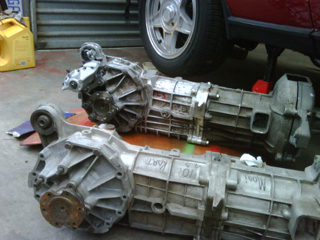

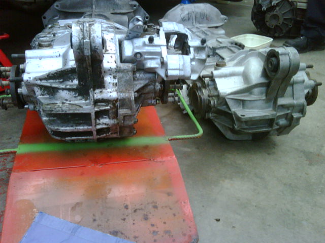

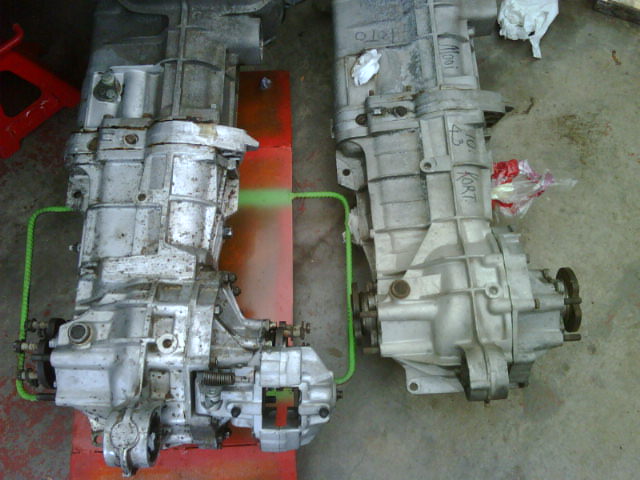

Guys , check out this gearbox . I thought something was different about . Where do you think this came from (origionaly)
If it's the one on the left the casting looks different, stronger I may say just by the looks of it, SZ/RZ maybe?
SZ/RZ would have oilcooler connections. :?
Giuliettaevo2 wrote:SZ/RZ would have oilcooler connections. :?
Maybe old alfetta then, really don't have a clue to be honest, just took a wild shot at it! :D
Could it be and ex autodelta casing. It has a 10 .41 LS inside but that could have been changed anytime. Every webbing on this casing is twice as strong as and origional. Any of you 75 guys recognise it ?

I have an ooold Alfetta box in the garage and it looks slightly different in the casting, I'll try to snap a pic.
Thanks guys, would be interesting to know if this one of those special boxes. I found a speedo drive that was converted to and oil pump as well with a filter.

Hey Kevin, I had a look on my old alfetta tranny and it looks just like yours (ie, with thicker webbing) I think it's earlier casing that's all. Or maybe I'm also in possesion of super duper tranny, which I'm unaware of :D That is rather unlikely, because it didn't last long behind the v6, not to mention open diff... Yet the ratios were sweet, Vmax below 200km/h, she pulled like rocket then... now my 4.1 feels like a cruise ratio.
The other tranny on your photo (the cleaner one :wink: ) looks just like the one I'm currently running, and that was sourced out of a Milano.
On the Dutch forum they agree with PietereQ, old casting Alfetta box. :wink:
Thanks for info, it origionated from an old alfetta race which had the adjustable roll bars I have. That explains it.
