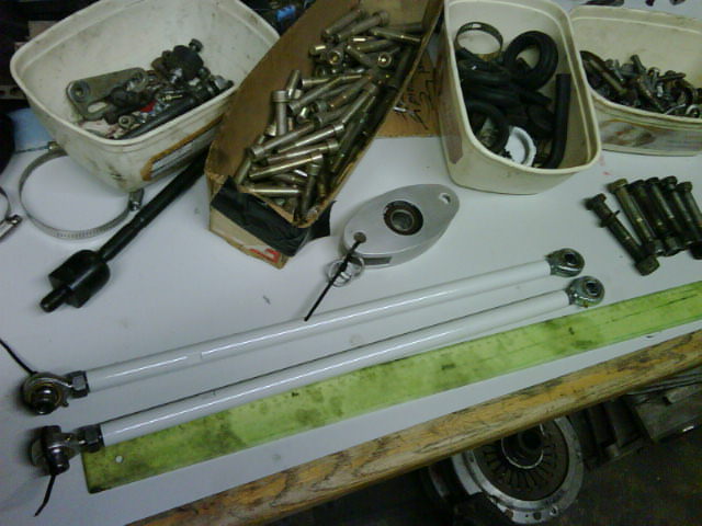

Btw. My uniballs have arrived, I have ordered the ones with ID of 10mm (for stock bolts holding the rods to the chassis). The tread is also M10, which seems a bit fragile to me. Will it hold the beating from all those lateral g's?

PietereQ, the lenght of rod is 44cm long. The uniballs are M12 with inserts where it bolts to chasis. check pics. you can see the bushes I made for chassis side, there attached with cable ties(not to loose them).
- IMG01322-20100801-2016.jpg (56.78 KiB) Viewed 9208 times
Thanks Kevin, that helps a lot! Still wondering whether to tap the rods or just weld the nuts on the ends. The id of rod is 10.90 mm so I dunno if the grooves of thread will be deep enough for M12, need to check it in the shop.
PietereQ, is not cheaper just to get a complete watts linkage from RS as youre in Europe unlike me with our import duties and freight its cheaper to buy a small car.

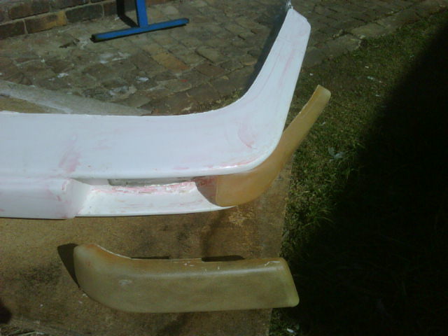

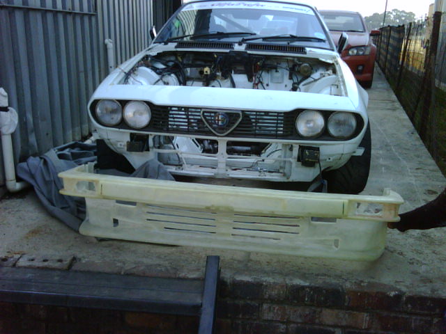

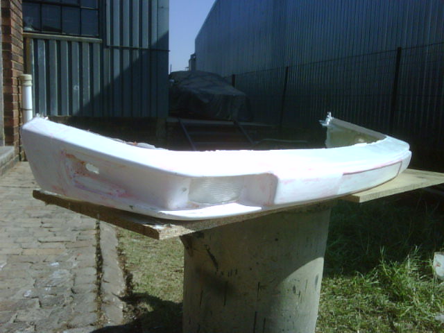

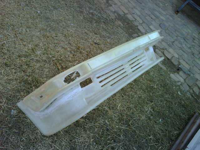

Quite excited about the new '' super lightweight '' front bumper spoiler combination for racing or for road. The combo unit is especially usefull for ultra low cars when loading onto trailers. Its moulded off the origional GTV 3.0 SA model front spoiler.
The only ''loose'' part are the side trims as you need to fasten the bumper on sides to body as per origional design. The combo unit is made from two moulds (bumper and spoiler) in order to maintain origional looks.
Check out pics pf progression to get to this point

Man i wish i was that clever to make things like that, Kevin they look great. Still grumpy about the bonnet!!! maybe you need to move to Aussie and bring all your clever stuff with you. Brisbane is magic.

fortom, i think you gotta be stupid to make parts for a 26year old car.
There has been surprising a lot of interest for the parts (rear bumper, front bumper, spoiler, spoilercombo and 3.0 boonet) so a friend of mine has decided to export this stuff from my moulds. This stuff is so light. As julian is now flying to SA on a semi regular basis maybe he can load a whole kit for you. Dont want to talk prices on this link as its not a vendor section but will work out something .

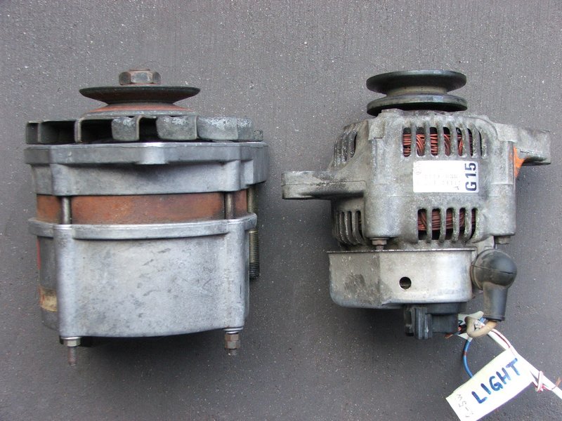

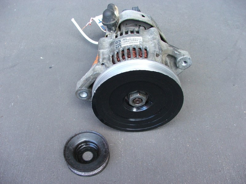

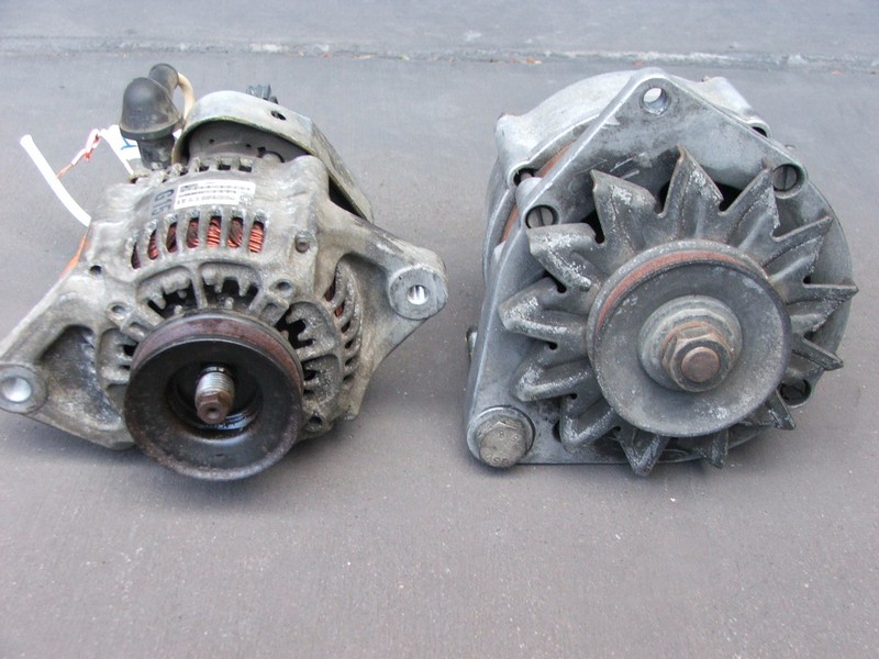

Kevin, you still need to fix your alternator problems?

Fiberglass panels include bonnet, boot lid,front bumper and spoiler , rear bumper, and doors. Saved 70kg over origional parts. Doors are now 5kg compared to 25kg. Bootlid is 4 compared to 14 kg.
