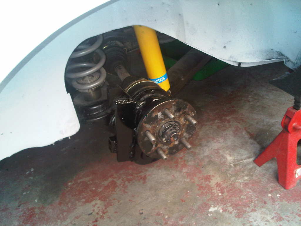

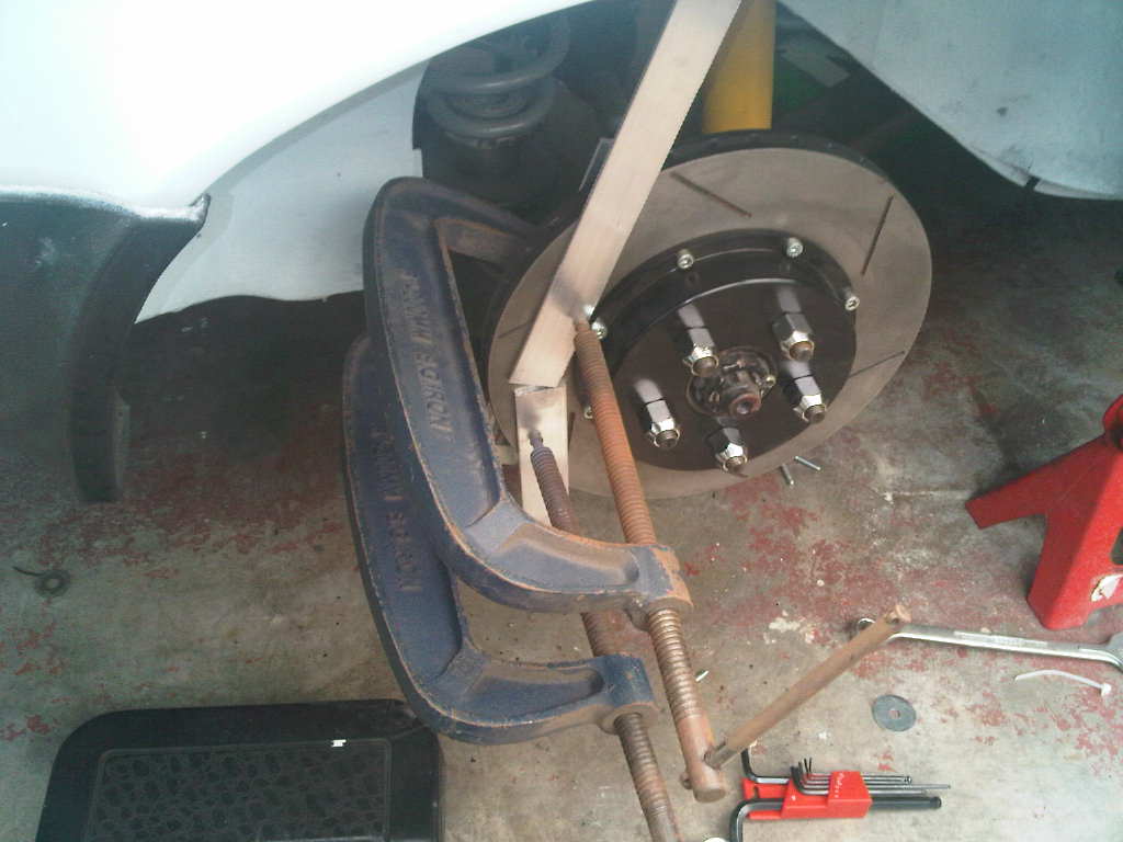

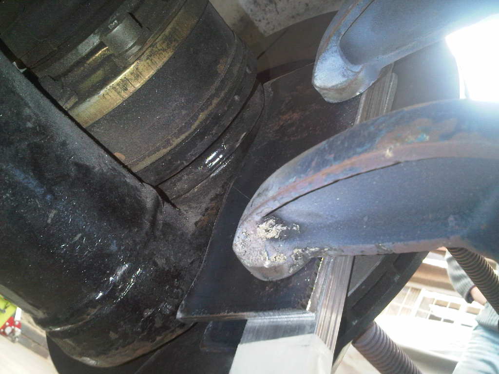

Pics of my rear brake set up which fit into !5 inch rims.
Process :
1) make bell and disc
2) work out distance for bracket A to be welded to dedion which was 23mmaway from disc
3) made 23mm spacers then G clamped a plateA which was profiled to the shape of dedion
4)Welded plateA with "special" rods to dedion hub which is cast iron. (hub on dedion is different material to rest of dedion _ you can see where hub is joined.
5)Then fitted caliper with another bracket(B) attached to caliper. this bracket(B) was then welded to bracket (A) when caliper and pad was sittining perfectly
6) re lable everything A and B if its confusing
pics might add some sense
7) connect new lines , bleed and got brakes in one day ( calipers and bells took a week to make)
Why did i do this ?? (to add more unsprung weight
no)
Take as much heat off my gearbox(trying to eliminate my gearbox failures due to heat induced). Also I have added an oil cooler which will post later.
Process :
- caliperbracketwelded.jpg (58.88 KiB) Viewed 7523 times
- calipergclamp.jpg (73.79 KiB) Viewed 7523 times
- calipergclampext.jpg (63.24 KiB) Viewed 7523 times

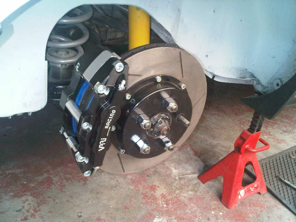

Pics of brakes on. My new bells or hats with spigot is been made also with two countersunk holes to hold it to hub.
- caliperone.jpg (75.7 KiB) Viewed 7523 times
- calipersboth.jpg (66.84 KiB) Viewed 7523 times

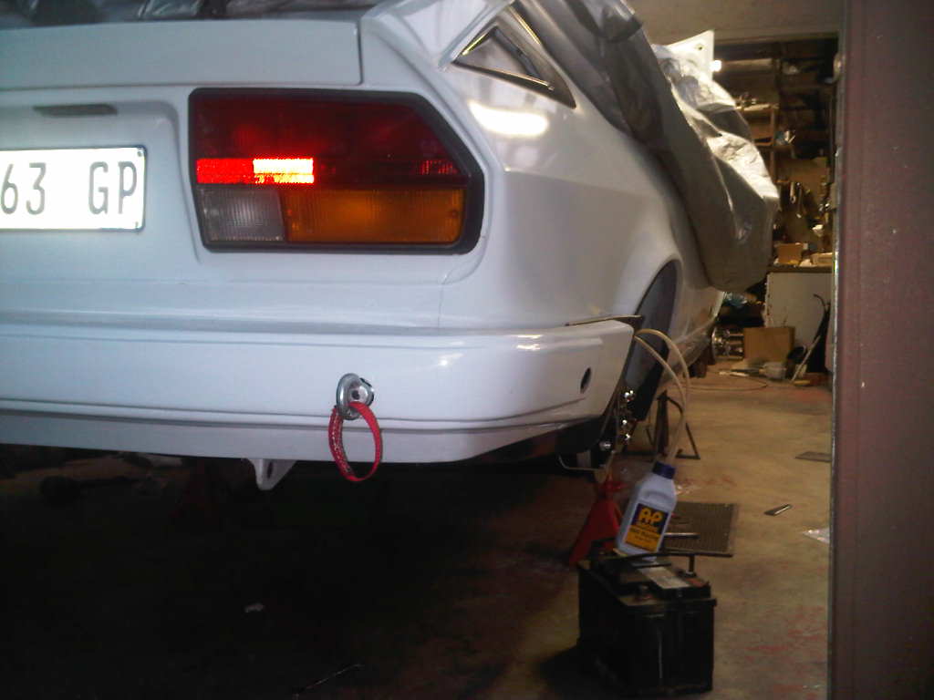

Other pics of my screw in tow hook through fiberglaqss bumper
- towhookoout.jpg (45.93 KiB) Viewed 7523 times
- towhookin.jpg (49.46 KiB) Viewed 7523 times

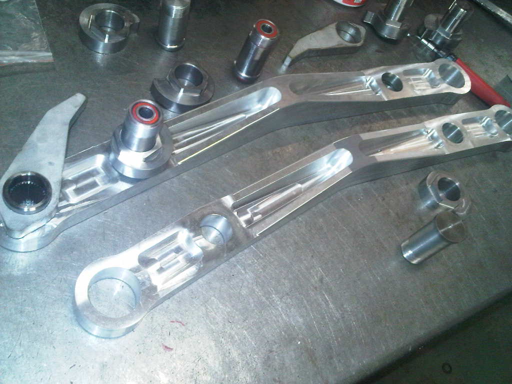

I made this set up for a few guys here who still have to run torsion bars. Its nearly perfect . I had this set up on my car , it save hours and especially iff you are doing corner weights with a combined RS coilover kit.
- torsionadjuster.jpg (83.08 KiB) Viewed 7399 times
That, my friend, is a work of art...
Very nicely done! Did you reuse the part where the torsionbars slide in, the ring with splines on the inside i mean? That would be the most difficult to make i think.
This is even better as the old Autodelta part.
I can only say that this is a work of art!
how much for it?
I'm getting the Giulie ready so this would be very helpful to set up the suspension easier!
how much for it?
impressive work their kevin,
so this to tweak ride height without taking torsion bars out and roating?
this would save me alot of time
any chance of selling a drawing
I'd be putting a one way valve in the return line and carrying extra oil capacity on board (expect would be about a litre extra, so is hardly a problematic weight penalty).
Also, would return via the fill plug, assuming the idea is just to keep the oil at its optimum temp, not change the internal oiling characteristics in the box (the gears pretty much run totally bathed in oil anyway, as far as I can recall - don't have a box in front of me at the moment, but the fill plug is at/very close to the top of the box, is it not?).
TB adjusters are very nice. Is the alloy as strong as the cast steel (or is it moot anyway)?
