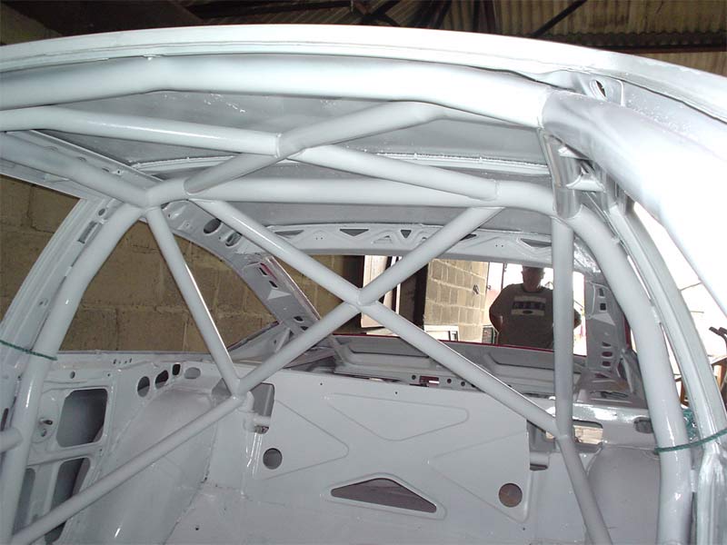

Anyway back to my flimsy cage. Md you can see if you look closely under the cages brackets, there are the 5mm plates welded. Not hard to miss that welding(the brackets are all painted white. The wheel arches have plates welded in from under the arches also with the nuts welded to the plates as in all the others. pic to follow

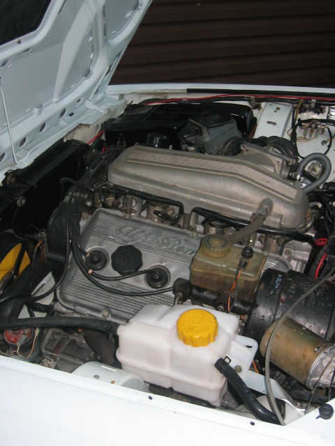

Digressing a bit, did some testing today and found the waterbottle severd its 25yrs . Replaced with a chev bottle. Not a great fit but does the job. Must get the correct cap for waterbottle and install the over flow bottle(regs). If anyone is going to do this(use chev bottle) in their road car make sure you dont use these high pressure caps as our heater systems cannot take it and will burst. These high pressure caps are normally 1.7 to 2 bar and our specs here on the origional cap is 0.7bar. Also found the T piece behind the engine had totally rusted closed. You can see if its blocked if you rev the motor and no water squirts into the bottle(small hose on top side of bottle).
- IMG_2367.JPG (106.22 KiB) Viewed 9655 times

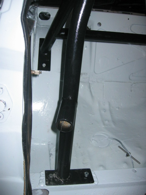

Kev, Matts, everything is not what it seems first sight. Feedback from you Matts is relevant on the basis of what you see which is not enough. So I have added a couple more frames to illustrate exactly the points you expect to be there and then some..
The base of the mount is effectively a 6mm box section and it cannot collapse nor can the 16mm high tensile bolt sheer off as the base connection is restricted from any sideway movement by other components. Also not shown are other cross bracings to expressly cater for side impacts.
Yes, my half cage on this vehicle is for road use only. Hope that clears it up.
- LHS Main Hoop Connection with Cross Brace.jpg (236.86 KiB) Viewed 9655 times
- Cross Brace at Hipline.jpg (238.15 KiB) Viewed 9656 times
