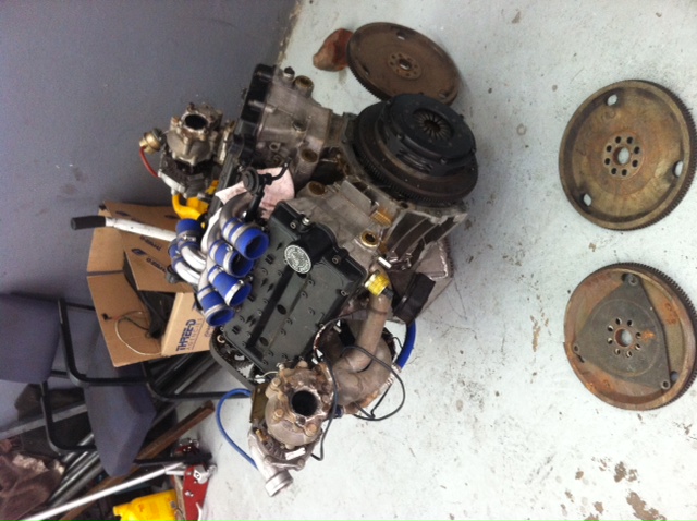

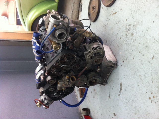

Now thinking of phase II of this development... we are reaching end of the season soon.... Nov, so my thoughts are to now go to next "level" :twisted: for next year..
See Pic below of the motor I am thinking of... (at Dom's)..Then maybe a Front mounted box???
Rear view of Possible Phase II
next phase 2.JPG (133.07 KiB) Viewed 8004 times
Front view of possible phase II
next phase 1.JPG (126.18 KiB) Viewed 8004 times

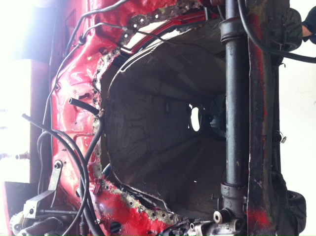

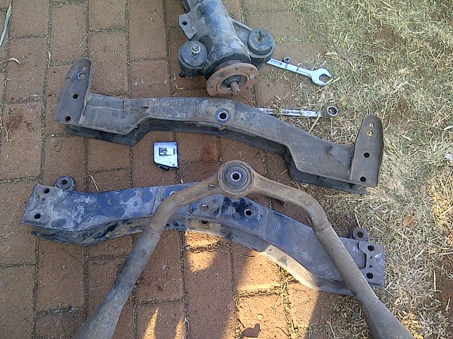

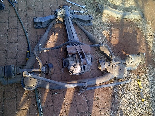

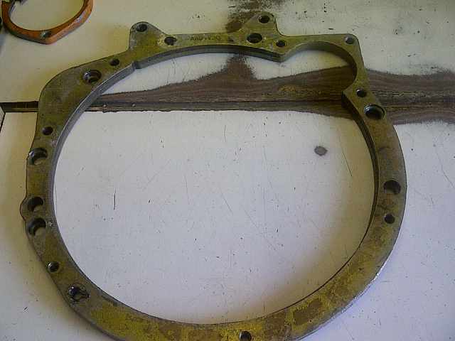

Anyway, below are some pics of the intended route we will be taking (thanks Kevin) for the frount mounted BOX - the pic of the box is missing, on its way soon :wink:
measuring up the parts!!
measuring up.jpg (137.74 KiB) Viewed 7979 times
the cut out and tunnel to be used - will be TIG weleded
tunnel lres.JPG (120.14 KiB) Viewed 7979 times
laser cut flywheel spacer to be used for Gear box front mounted
laser cut spacer.jpg (141.97 KiB) Viewed 7979 times
Comparing the 2 crossmembers for fit and size
comparing crossmembers.jpg (143.69 KiB) Viewed 7979 times

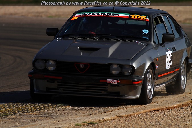

one or two pics from the race event last saturday.... I know it will not mean much to most, but I did my PB of 1:17.931 on race day,.... was great!!!!!!
A left hand corner... but front wheels pointing a little right :)
2 nov 2012 a.jpg (118.81 KiB) Viewed 7878 times
Mmmmm ... using a little more than the track!!!
2 nov 2012.jpg (127.11 KiB) Viewed 7878 times

Re: A new GTV6 2.5 entry into SA Marque car catergory
Joemart , just watched a video of race from a slower car . Your car handles well ( no credit to the driver how it cuts through the field) . If you compare pics there are two shots taken of your car and my car from from exact position . It shows clearly how my front is stiffer than yours ( that does not sound good :oops: ) .
My rear is 65kg , yours 50 kg
My front is 200kg , yours 120 kg plus 24mm torsion bars ( probably = 170kg )
Also I have rs front anti roll and yours is Standard .
Time will tell when front box is in on your car how it affect your times .

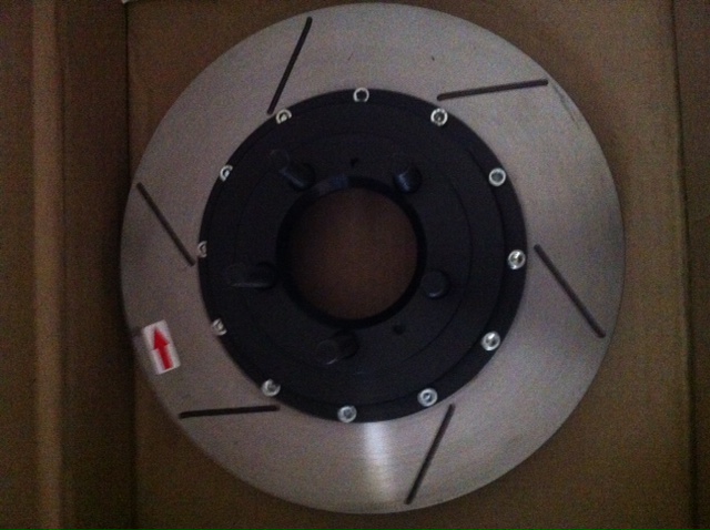

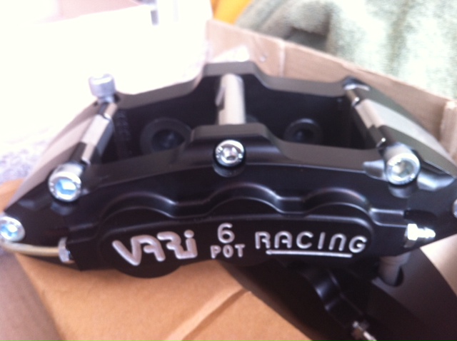

Been a while since last post :!: ..... But here is a small update - The brakes (courtesy of Kevin) have now arrived and will be ready for installation... great piece of work!!!!!
disk 2
disk 2
brake disk new low res2.JPG (112.11 KiB) Viewed 7790 times
disk
disk
brake disk new 1 low res.JPG (112.02 KiB) Viewed 7790 times
See Post by Kevin on details
calipers 6 pot low res.JPG (85.12 KiB) Viewed 7790 times
Hey , hurry up and put them on :D
