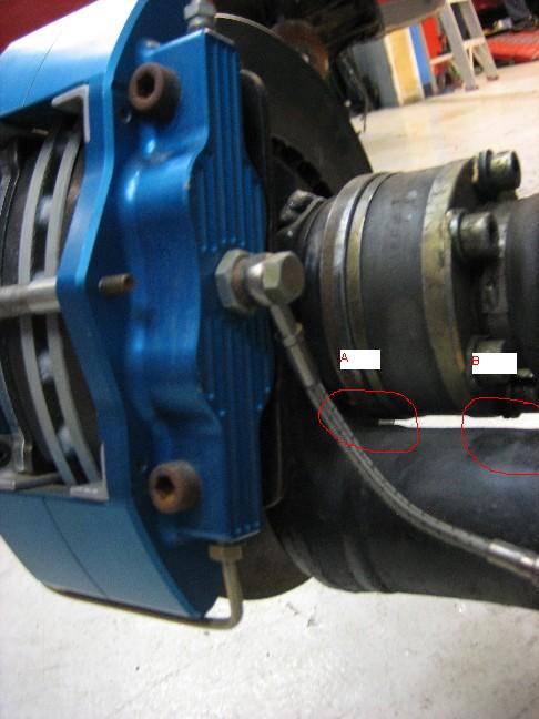

I tell you what happened in all likelihood - go look at the clearance between the TOP of the DeDion hub "ear" (part that holds the wheel-bearing housing) and the bottom of the CV head where it bolts to the little stub-axles - there's just about nothing there - especially on a V6 car!
So, if you create the cut/bend/weld too close to the hub, you run the CV right in to the DeDion...!
There is a VERY specific spot where it needs to happen and it is pretty close to the hub...
Even so - 3 degrees is like a ball-hair - you can move the tube 3 degrees by simply running a weld across it...

In short; the space between the top of the DeDion and the bottom of the CV...
In the pic below - if you cut/weld the DeDion and add negative camber at (or around) "A" - you'll drive the CV right down in to the DeDion around "B".
However, if you cut at (or just maybe even to the right a bit of) "B" - you'll create the "dip" at the CV where there is room and flex in the side-shaft.
Believe me - the angle of this picture is generous for the amount of space that is there on a V6 CV...

Which is why you "Use a narrow cutting disc and make two cuts 10cm to each side of the watts link" as Matts described.

NO WAY!
Cutting and welding to the INSIDE of the two forward tapered DeDion arms? Now you have to still fight them where they are attached at the outer-limits to the rear bar as well as at the front of the triangle!
Also, cutting and modifying on the inside of the triangle - how the hell do you change the tow now!? (Again with the two hypotenuse bars still attached!?) Nah - do it outside of the triangle - just under the CVs...
If you want to do it the hard way I won't "nag" you but anyone else reading should know that the cut/weld around the watts pivot is very easy and stable. Plenty of cars running it and no failures in probably 15+ years.
