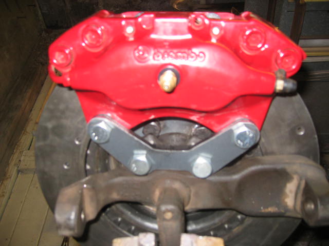

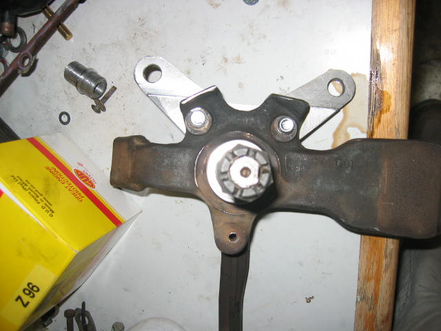

Pete, going back a few posts on calipers. I will posts pics on the hardest way to do a big break conversion with 15 inch rims(and only a select few 15nch rims). I think keeping the 315mm disc size realy made it difficult and using calipers that have 'lugs' make it impossible unless you can laser cut the pieces. Check out pics.
Mats what do you think of the shear on the bolts or the "meat' left on hub.
What's that, M10? I'd be worried... :?
Mats wrote:What's that, M10? I'd be worried... :?
Never! No problems here with m10..You will break your finger off in your ass before those m10 will shear! 8)
Geez Baz, you sure got some strange ways of doing R& D for brakes down your way. I can see by the time Kevin sorts his brakes out, he wont be able to sit down for a week... :D
Adds a whole new discovery channel to pickin' your nose too I might say.. :D

The problem is that there is no way that the friction between the bracket and the spindle can take that kind of torque on a small PCD like that. The bolt will take a lot of that load in shear.
That's not the proper way to design it, but I guess you don't care until the bolt snap. :wink:

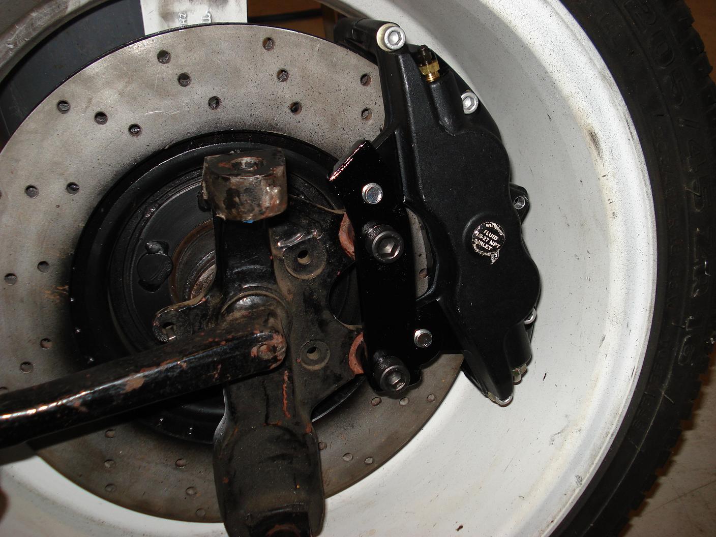

the double caliper thing was original on the Giulietta Turbodelta... it uses very rare autodelta spindles and two calipers each side.
Don't know what they did with the mastercylinder to make it work properly.
I used Volvo 240 calipers, they are 4 pots. with the Giulietta 1.6 Spindles and the hubs and discs off a 75 TS this is a bolt-on job. only trouble was the double brake hose connection on the caliper, fixed it with a t-connector and two pieces of brake line.
Also used a mastercylinder of some kind of Peugeot/ Citroen van which is 25.4 mm. was 118 Euros but has the connectors on the wrong side( near the engine) so i had to lengthen the brakelines.

gut feeling says, M10 and the large brakes is not strong enough.
Ps comment on the V shaped bracket, I would like to see material between the bolts. Even if it is 2mm material, it helps a lot.

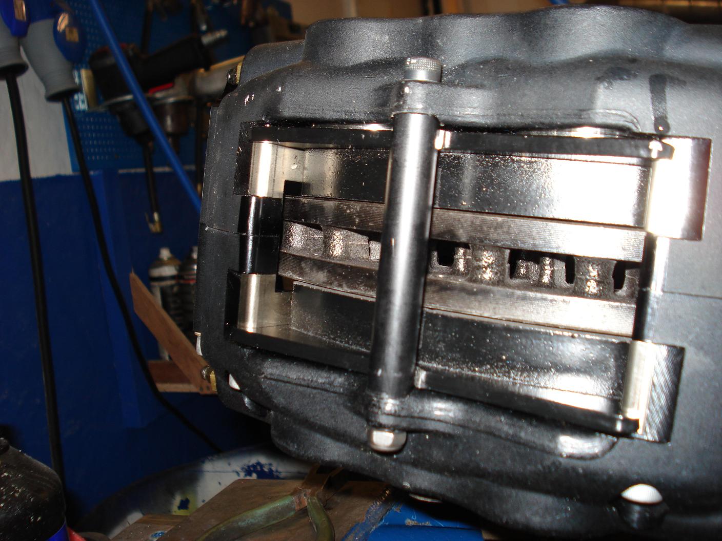

wilwood disk (29.6mm) is wider then an SZ disk.
An standard caliper which utilizes 29.6 mm will be difficult.

Thanks for replies. Also thought of welding around the sides of bracket but then you also weeken areas around weld.
