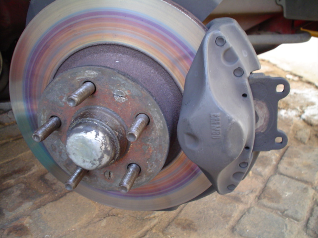

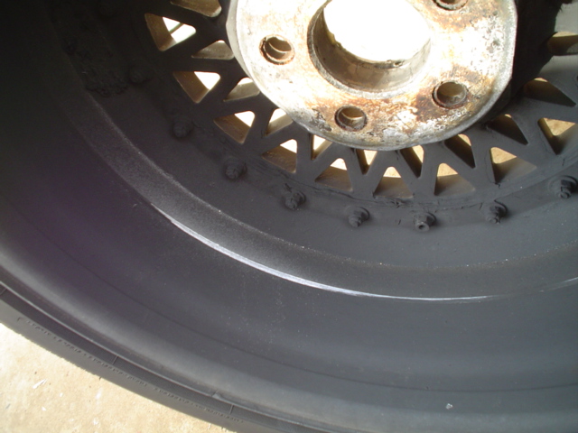

:!: Got a "new"30l gtv...Driving along at 160 -170km/h on the freeway and had to apply brakes rather firmly(speed camera... :oops: )
Car was all over the place...some ol granny actually gave me the finger as she passed me....
Thank goodness for 15" rims....17`s,pads out...
No retaining pins...Mmmm..
Murray

Barry I don't know if this is your situation but I have noticed that my pins have a nasty habit of trying to work their way out of the caliper.
When I'm at the track I check them after each run.There's some kind of a little "c" clip that should maintain their position but I guess they weaken over time.
Then again maybe you were looking for a little excitement and simply left them out :lol:
Murray,new car,new engine,having fun...checked the pads through the wheel....and driving it...Stupid I know,but I did it...
Made new pins with threaded bar and locknuts either side....

Murray,been thinking bout your pins migrating east...
You know our gray Loctite silicon??It will hold a wild bull in place,yet easy to remove when you need to..a blob on the pin head..?
P,Yea,it felt wild...on a track you expect stuff like this.and you can prepare for banging the wall..but on the freeway with other users AND you`re being a bit of a n asshole with your driving,its not reccomended.. :wink:
My guess is that someone forgot to install the pins.
Or, the pins were damaged (I've had bad, rusty, ones which had lost the locking ring).
Or, they were seriously wrong installed.
With normal pins installed as they should this does NOT happen.
Micke,agreed...I just got the car and ovhauled the engine..
Been driving it about a week...yea,I know should have checked but I did not..
No pins installed at all.. :oops:

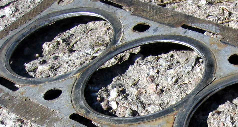

I took a photo of the head gasket. You can clearly see the different offset of the 1.8 ans 2.0 engines. Look how the pistons have been smashing the gasket.
Head gasket.jpg (90.13 KiB) Viewed 12803 times
:D :D So Micke,You going to fit the correct gasket to your race engine now?? :D :D :wink: 8)
Naah,
I found this a gooood way to increase compression. So, now I'm looking for a 1300 gasket 8)
