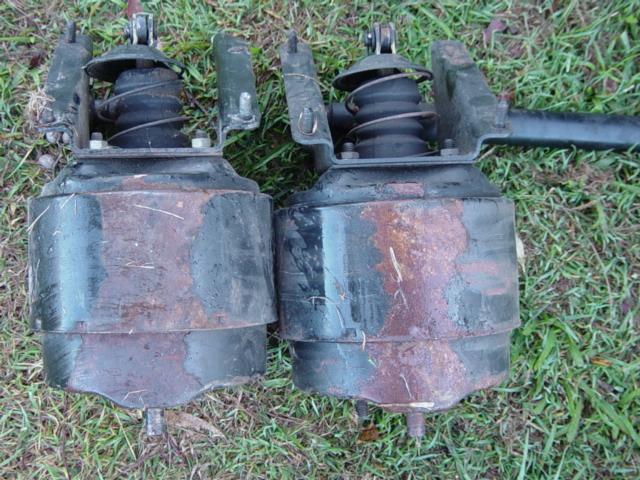

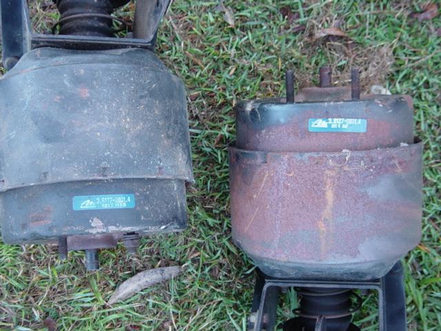

If you do mean the brake booster, Two I have, one from a GTV6 and one from a 75 look identical, same part number. See photos below.
The GTV6 booster came from an accident damaged car and one mounting bolt is missing.
David
GTV6 on Left
GTV6 on Left
GTV6 on Right
GTV6 on Right
Boosters 2.JPG (69.88 KiB) Viewed 13032 times
