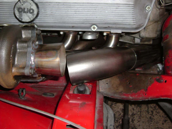

All piping was or is 42mm ss (id)..with a slip joint under the engine..no ss bellows,only a good old dinosaur slipjoint.

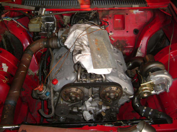

Very nice! your estimations sounds ok!
Do you have room left on the turbo side for the downpipe?any pictures?

yeh am still trying to figure out how to resize photos so i can post. can anyone help? the dump passes through on the same side as the turbo sits because i have cut out a section of the passenger firewall and made an opening there. so not only was i able to pass a 3 inch dump it also allowed me to run the catalytic converter and rest of the exhaust in level with the chassis rails. this means i can make the car super low if i wanted too and the exhaust would never hit the ground. in regards to the clutch issue ,while i first run the car and get everything sorted and working how i like i will be limiting the boost to whatever the standard clutch will take. once the rest of the car is fully sorted and 100 percent i will most likely raise the boost and have a triple plate road/race clutch waiting in the garage. with this clutch i have the option of running it as a double plate or triple plate so i guees it comes down to trial and error and seeing what the thing will take, but im told it should be ok for about 400-500hp. with the use of the sm2 autronic though i will be able to limit boost in the midrange and put it in up higher in the revs where the standard clutch is less likely to slip. having said that once i put the good clutch and in partenership with the 9 inch rear slicks ,will probly blow the box. thats when the car gets chopped up and i fit the biggest and strongest box from another car i can find.
