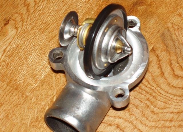

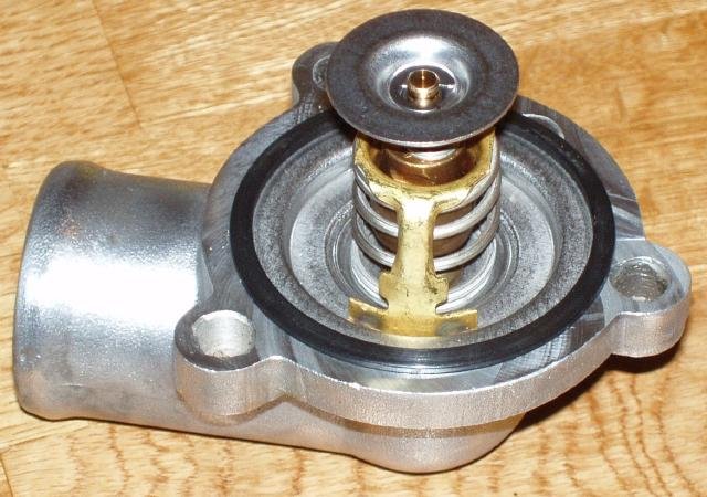

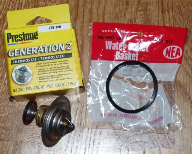

the model ford is the ford falcon. a very poplular car down here and because of that fact can buy thermostats in all different heat ranges. i just choose the coolest they had which was a 75 degree i think at the time. but like i said a very easy and simple conversion indeed. and cheap to boot. so cheap in fact that you can afford to change to hotter thermostats in the winter and cooler in the summer.

This is what I use
