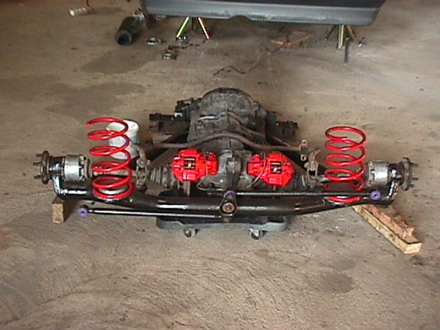

Too mutch has been done this past year too give you all the pics, but I´ll sum what has been up till now, and will pick it up from there.
The car is a Alfa 75 2.5 from `87 with a 3.0 engine from `90.
*Lowered with 30mm torison rods and race springs in the back.
*Bilstein sport shocks.
*Gearbox from 75 TS
*Totally ripped out interior
*Battery moved back
*ACC and orig. PS ripped out to loose weight
(PS was leaking, so I rebuilt it to manual stearing. Lost 15kg)
156 V6 24v -98
GTV6 3.0QV-83

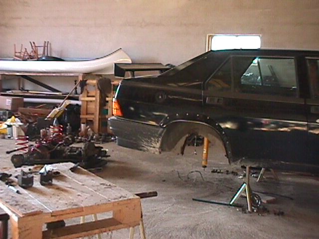

A few more pics old pics
From now on I will report what´s going on now.
enjoy :P

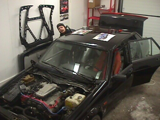

The plans for the winter is to lighten it more (as much as possible after low budget messures :) ) Also to put a full cage in it, get another race seat, service the gear box and engine and other small stuff.
Skirts and an EVO front is ordered aswell.

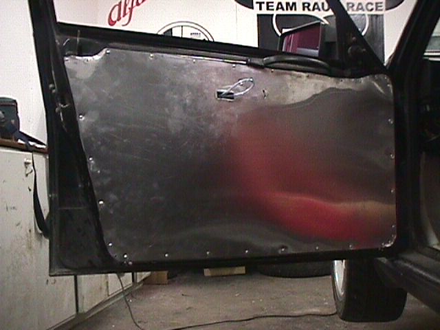

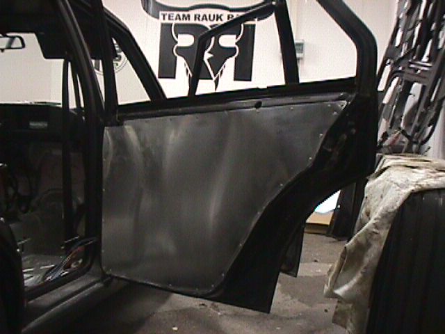

At the moment we´re cutting metal out that we don´t need. Members inside hood and trunk and stripping the doors and replacing the inside with aluminium sheeting. Plexi will replace the glass (makrolon)

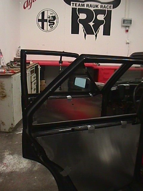

Quite a lot can be cut out from lids and doors. To prevent us from cutting ourselves on the sharp edges, we dress the insides of the doors with alu. sheeting.
Hold out for next time, more will come :twisted:

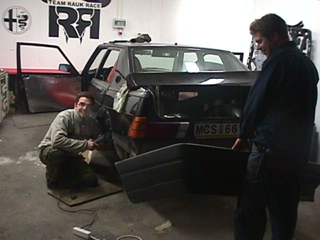

Now the door panels are all finished. Next is to put plastic (plexi) windows in the doors and rear.
Since the EVO-front is in the making the bumpers come off too. The one in the back will be put back again, we just wantad to see what the wieght of it was. Not much really... 4-5kg´s maybe
´till next time dudes!
