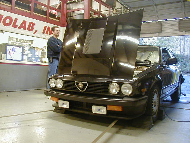

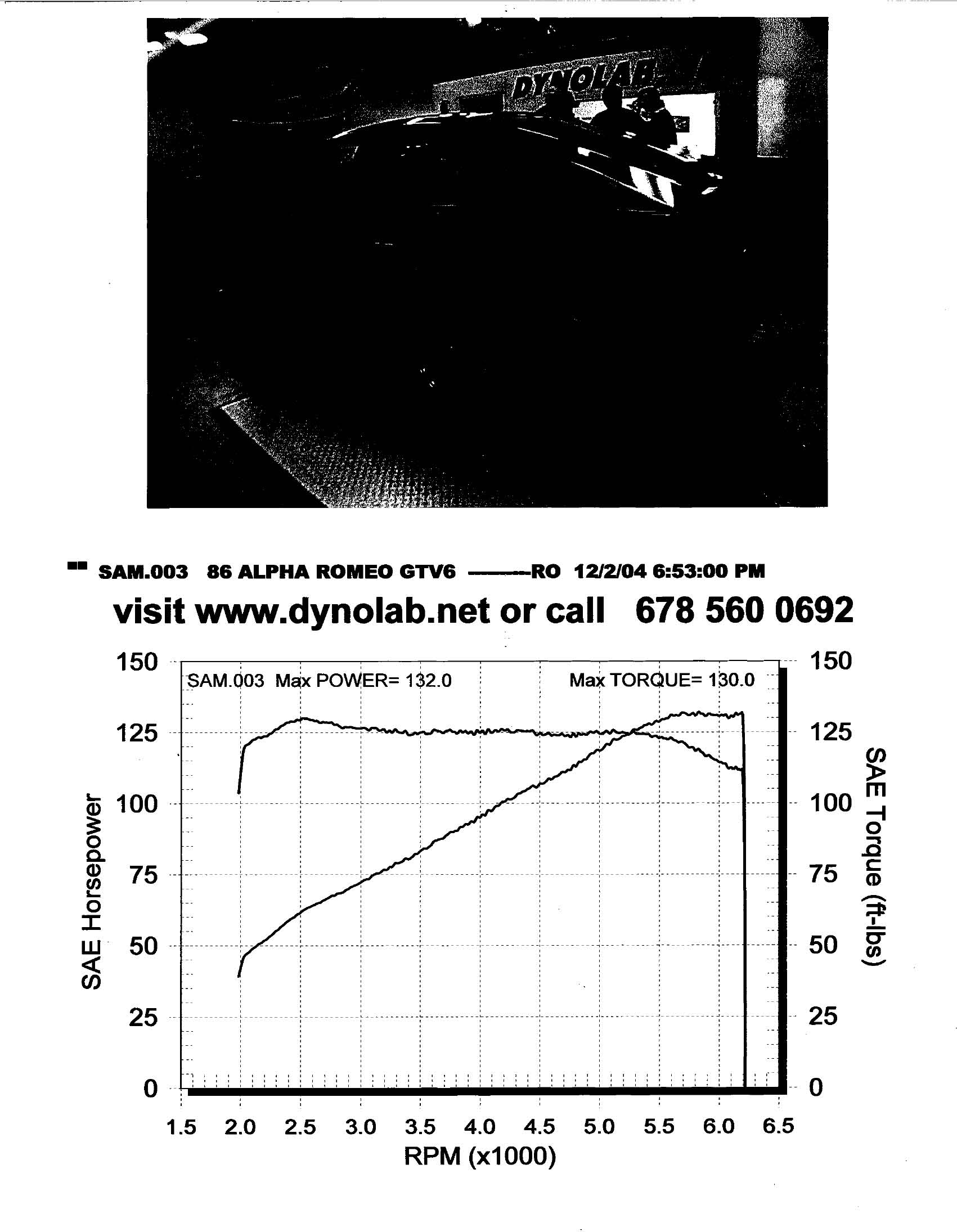

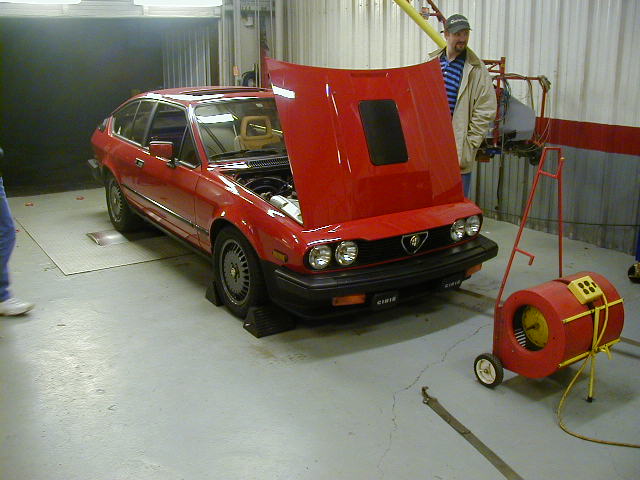

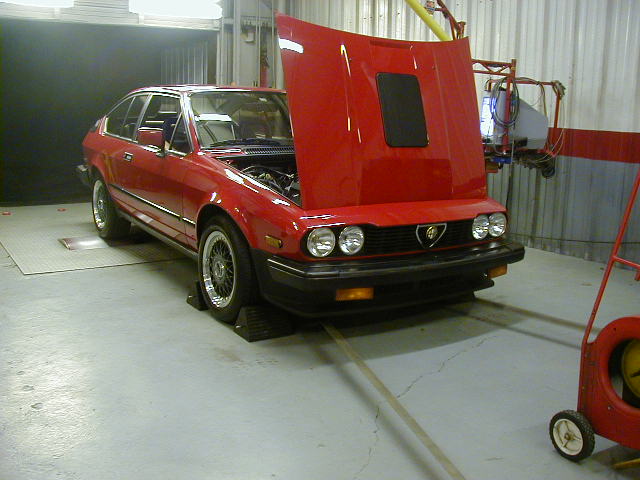

I have the CSC's on mine, with Port & Pol heads, oversized valves, but I am also running cats for emissions, we did a dyno run last night, and two friends with '85 & 86 GTV6's stock except they have no cats, and we all ran about the same numbers, I think I was middle in HP and Torque, but I have the smoothest lines. HP was with in 4 of each other and Torque was with in 3 of each other.
- 17% loss through transaxle
- Dyno Run.jpg (228.02 KiB) Viewed 17472 times
Nice smooth tourqe curve you've got there Sam, with a bone stock 2.5 some years ago mine showed 131bhp atw also at 5500rpm (dropped a hp at 6k) So it looks like your motor is fit and well.

Dave, that's cool that you ran 3 up at the same time.
Assuming they are all similar gearing is there much difference in how they feel on the road?
The HP curve is really smooth. Can you post the others? I have seen some pretty shaky ones out there.

Dynonight

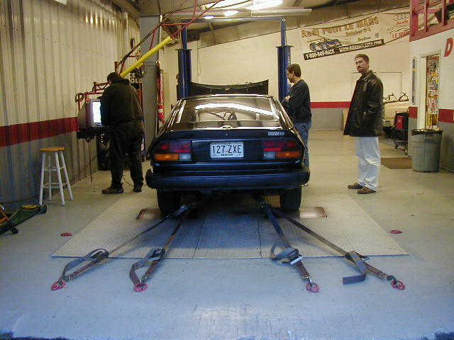

Yeah, it was great to run 3 all at once, same night, same dyno.
I have driven Sam's. His is a beauty, prob the best cared for higher mileage example you'll ever see. 1st thing I noticed was that his higher tyre pressures worked so much better than my 'factory recommended settings'. I now run 30psi all round and am still experimenting. He has Toyos, I have Kumhos. Both great tyres, can't tell if there's much of a difference between them.
Other than the tyre issues, I think both cars feel very similar on the road. Our gearing is different (we've had endless discussion about this) - mine is travelling @ 80mph @ 4k RPM. Year of mfg of mine is late 84, I guess the diff installed then may have been the 4.11. I have the link to that info somewhere...
One thing I have learned is that if your 'box doesn't work right, you're really not enjoying your Alfa. Sam and I overhauled my box, which had the usual impossible-to-downshift-into-2nd problems. Now it works perfectly. It's non isostatic, with an improved pivot fork bushing (roller brgs). Before the overhaul I was only enjoying the car 70% of present. The car was a bear to drive. Taking Sam's for a spin really underscored that.
We'll post some more dyno graphs in due course...need to fire up the scanner on Monday and do that.
Oh, Sam mentioned the Italian tune-up. It was amazing how much cr@p was exhausted from our cars on our first runs. After the initial cleanout, the second runs tended to produce more power. From now on, I'm going to blow the cobwebs out every once in a while...I promise.

That is mostly what I have thought about all day, since I am no eletrical engineer (like Dave), the Gotech sounds like a good option, I would like to talk to someone who has fit it to a 2.5. Looking at my chart, I think the AFM is the hold up in mine, I should have no problem with exhaust flow. It was interesting, we popped off my air filter for the last run and I lost 2 hp and picked up 2 ft/lbs of torque, the chart I posted was the 2nd run.
I think to confirm what has been said many times on this forum, a stock 3.0 Verde put down 170hp at the wheels, that truely is the best bang for the buck, but I will continue to work on my 2.5.
