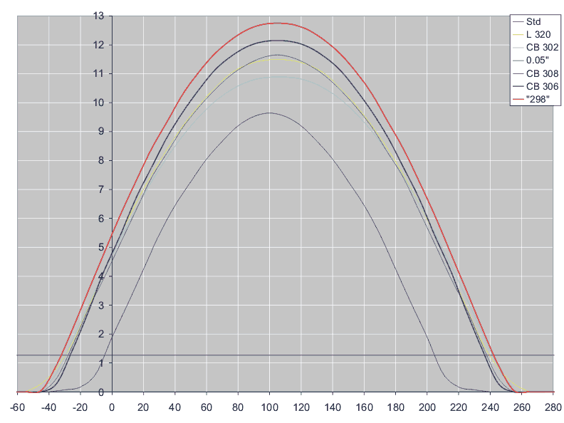

Any opinion on the cams?
Std should be obvious
L320 I have now as intake
CB302 is my current exhaust
"298" is my new intake (Camzilla on the picture)
CB 306 is my new exhaust.
CB 308 was an option I disn't take.
Micke, in the first place, how did you decide to use different cams for in/ex? Did flow measurements show the exhaust flows too much?
Is all this for a TS or 105 Nord? What is the rpm range of the engine,CR, valve size, which exhaust manifold, carbs? Sorry but I must get an idea what you're trying to do! Is it 100% racecar? If yes, use the highest CR for special competition fuels (some guys here use 13,5:1 with special imported-expensive-gas) Then, you can also go with 12,7-13mm lift and 280+ @1,25mm and forget about anything below 4500rpm. If you want to be top banana, call Alfaholics (UK) and ask about the big-valve Evans head, but you'll wave goodbye to about 1500GBPounds. They reportedly make more than 200hp with all the right stuff, pulling from ~5k-7,5krpm.

My current engine is a Nord with original valves and ported for race/street. Produces about 180 hp with 48 mm carbs. Not much punch below 3000 rpm and good power from 5 to 7k5.
The new one will be race only TS. 46 mm itake valves. Original exhaust. Yes, according to our flow measurements the Nord at least can do with milder exhaust valves than intake. Not sure about the TS with smaller exhaust valves. Might need to change them.
Fuel injection as we discussed in another tread.
Exhaust planned to be 42 mm primaries stepping up to 45 after 30 cm. 45 cm of this into a 60 mm collector which should be 74 cm long. After this as open as possible.
CR about 12.5. I don't expect or need any torque below 4000 rpm. Useful rpm range hopefully about 5-8k with best power between 6 and 7k5.

Flow testing the 105 head has shown the ex valve to be too large. I will have to test a TS also, but they have 38mm ex valves. I suspect they would work very well with 46 intakes (although you have more shrouding in the TS compared to the 105).
