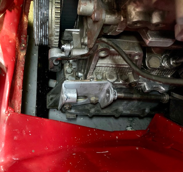

Mate of mine Stavros suggested this alternator and after a few test fit I need to modify my original bracket by 21mm to bring the belts into alignment on my 164 24v based motor .
A new larger alternator cable was needed .
This unit is lighter than the original with built in cooling fans .
I am currently laser cutting the adjusting bracket . Some pics to follow.
