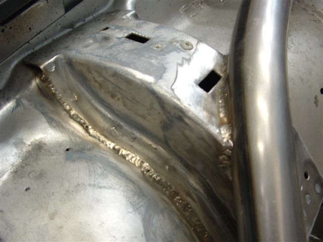

Find below some pics of the cage in my 3.7 track car. In those pics door X'es still remain to be welded in.
- G2-TCM MX5 011.jpg (81.73 KiB) Viewed 12240 times
- Passing the shock mount
- G2-TCM MX5 003.jpg (51.01 KiB) Viewed 12261 times
- Through the firewall to the front
- G2-TCM MX5 010.jpg (59.22 KiB) Viewed 12261 times
- G2-TCM MX5 005.jpg (53.44 KiB) Viewed 12261 times
- G2-TCM MX5 006.jpg (57.26 KiB) Viewed 12260 times

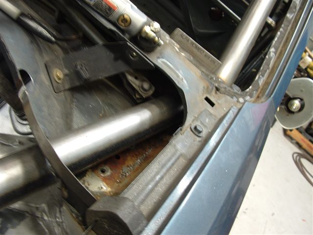

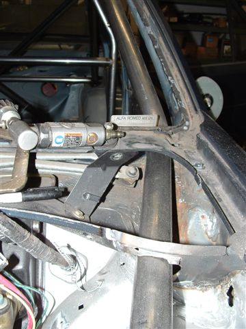

A few more...
- another angle
- G2-TCM MX5 020.jpg (61.32 KiB) Viewed 12248 times
- Terminates at the castor arm mounting point
- G2-TCM MX5 015.jpg (56.23 KiB) Viewed 12249 times
- G2-TCM MX5 029.jpg (47.85 KiB) Viewed 12247 times
- G2-TCM MX5 024.jpg (88.6 KiB) Viewed 12249 times
- yet another angle
- G2-TCM MX5 017.jpg (70.15 KiB) Viewed 12250 times

Does anyone have a good idea whether the above with seam welding and a cross brace would strengthen the front sufficiently to run coil-over ONLY at the front? (i.e. ditch the torsion bars).
Ok, I think I'll get in contact with Ron for a suitable front spring rate (matching the RS kit without the torsion bars).
Credit for the cage goes to our outstanding Icelandic fabricator, Jonni. It is his work of art with input from me, JJ, and the guys at group2.

The second thing is minimal. I would seam weld and preferably add at least a 2mm plate inside the shock tower mount that will be carrying the suspension/spring loads. I am doing this in the next couple of weeks. Can PM you a pic when its done if you like.
Nice welds..

Nice fab work, but I would have done the rear half of that cage differently, and run a diagonal in the main hoop. You've got alot of tubing there that's not really doing much in terms of stiffness.
One of the early M3 websites has an excellent collection of assorted cage designs as used in Supertourers and Trans-Am, these are a good starting point for seeing how cages are done properly (ie designed and analysed using FEA packages).
http://e30m3performance.com/tech_articl ... posium.htm (Found it!)
Main issues I have are:
The tubes that run forward to the suspension pickups don't really triangulate much. I'd run an extra pair of tubes back to the firewall/under dash brace (tied into the firewall, not just passing through). These might have to be bolt in for engine removal. The braces don't need to run all the way to the CCA mounts, just to the shock mount, because if you hit something front-on, those things will distort the cage more than they help.
The Main hoop needs a diagonal to help keep it from moving sideways. The bends in the main hoop uprights should have the seatbelt bar running across them (raise bar or lower bends)
The rear tubes shouldn't pickup off the top of the arches, they should run down to the base of the rear "firewall", and share pickup points with the cross brace. (The horizontal tube between them does bugger all for stiffness, its tubing that would be better used elsewhere) I'd also run a pair of tubes from the base of the main hoop to the base of the rear diagonals.
Needs a diagonal in the "Halo". THis will pick up a bunch of stiffness in torsion, and help prevent cage distorsion in a big hit.
Gussets in the corners of the windscreen - both at the under dash bar and where they connect to the Halo.
Just my 2c, not trying to get anyone off side....

I agree with most of what you're saying in theory but some of that is practically impossible to do. I've had to make some compromises with my cage to keep it street legal (door cross is not street legal in Qld).
I'll post some pics of how I did mine - not that I'm saying it is in any way the right way to build a cage.
